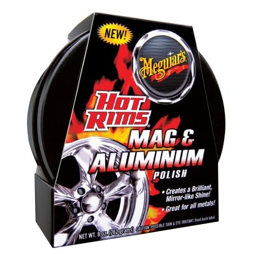

Old May 13, 2009 | 09:21 AM
vetteguy75's Avatar
vetteguy75
Joined: Jan 2003
Posts: 2,713
Likes: 31
From: Shreveport LA
LA Events Coordinator
I tried and LOVED Meguiar's Hot Rims polish. Ironically, I found it and ordered it from Amazon.com. It really puts a shine to aluminum wheels...makes them look almost chrome-like. When I used it, I got more comments on how shiny my wheels were than ever before....even after using Mothers.....
AND it smells great....like cinnamon

Old May 14, 2009 | 02:30 AM
327Heaven's Avatar
327Heaven
Joined: Apr 2005
Posts: 1,743
From: Hawaii
Recently bought a can of this terrific polish. Without question, THE BEST polish I have ever used......and I've tried them all.
