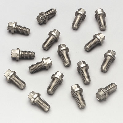

Word to the wise. Header bolts are notorious for coming loose. I use Doug Thorley headers with the thickest flanges in the business. While the standard header bolt threads on, not all that many threads catch (because of the extra space for the mount) and I've had these two bolts continually come loose until I replaced them with two slightly longer bolts.

I have Stans Tri Y's with 1/4 inch flanges so I have already thought of this. I want to use longer bolts also but I guess I need to know if I should use any special bolts that handle the temperatures, or just get some good grade 8 bolts. Maybe ARP bolts?

Try to use "header" bolts. The heads are smaller so you can get a wrench on next to the pipe. The problem is finding two that are a little longer for that first cylinder to account for the bracket. Luckily, that is not too difficult a cylinder to get a wrench on.

Also use a good header gasket like a Fel Pro and some high temp blue locktight on those stainless ARP bolts and you shouldn't have any problems with bolts coming loose.

Stan's sent me a thick graphite gasket with the headers. Seems soft enough that it would seal any leak. I don't really know. Thanks for the locktite tip. I didn't think of that.

Stage 8, they make a longer bolt also.
Again, make sure to test fit that bracket before you slam the hood down. Use clay or a soft toosie roll to check the clearance.
