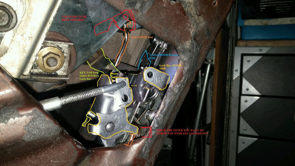

Found these,
Old Nov 21, 2015 | 01:38 PM
Jeffs82c3's Avatar
Jeffs82c3
Joined: Oct 2015
Posts: 4,782
Likes: 223
From: Lebanon Pa
This might help,

Hi Ernie,
About the latch, you posted this some time ago.
Is this helpful?

Originally Posted by Peterbuilt
Hi Ernie,
Is this helpful?
Originally Posted by Willcox Corvette
Fixed...
Pete... You are amazing I can't believe you saved it...
The pictures were still on the old site, (I still have it active for just this exact reason) but to avoid a site clash we had to change the address and when that happened all the old pictures I've posted here went bye bye.. Its just a matter of me digging up the new links on the new site.
Hi Pete and Wilcox - any chance you have these pictures still handy? I've been trying to dig them out of webarchives but haven't been able to find them yet. Really appreciate it, thanks!!
