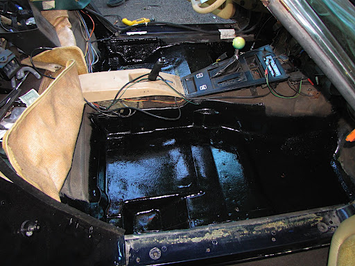

So far i ve striped the interior, preped and painted the floor pans with frame saver.

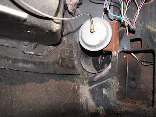

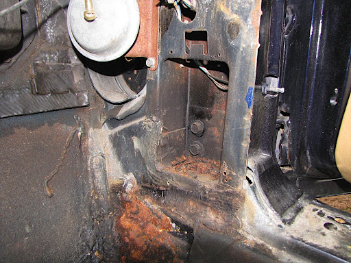

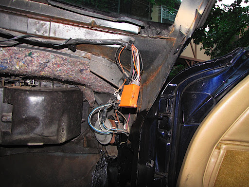

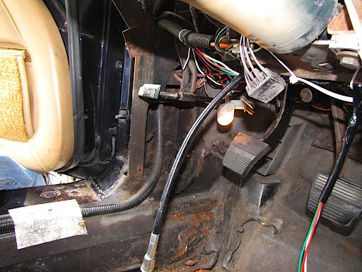

Thanks for your answer !

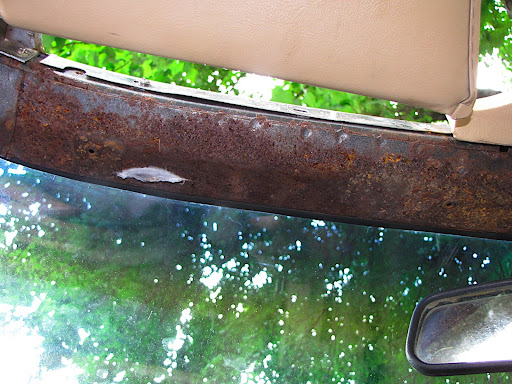

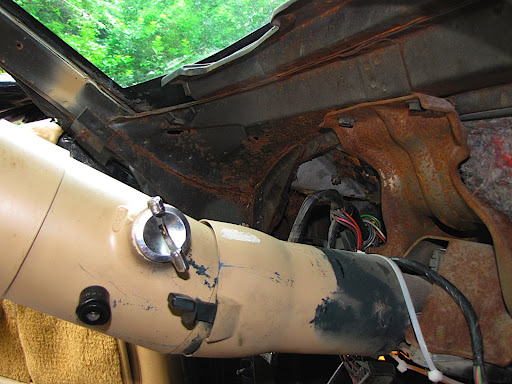

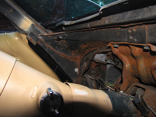

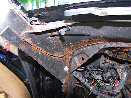

I ve got some pictures of the inside.
http://lh5.ggpht.com/_3hsqmEY856s/Sk...2/IMG_0183.JPG
http://lh3.ggpht.com/_3hsqmEY856s/Sk...2/IMG_0187.JPG
http://lh3.ggpht.com/_3hsqmEY856s/Sk...2/IMG_0193.JPG
http://lh4.ggpht.com/_3hsqmEY856s/Sk...2/IMG_0198.JPG
http://lh4.ggpht.com/_3hsqmEY856s/Sk...2/IMG_0204.JPG
http://lh5.ggpht.com/_3hsqmEY856s/Sk...2/IMG_0206.JPG
http://lh4.ggpht.com/_3hsqmEY856s/Sk...2/IMG_0229.JPG
http://lh4.ggpht.com/_3hsqmEY856s/Sk...2/IMG_0235.JPG
http://lh4.ggpht.com/_3hsqmEY856s/Sk...2/IMG_0255.JPG
http://lh4.ggpht.com/_3hsqmEY856s/Sk...2/IMG_0205.JPG
http://lh3.ggpht.com/_3hsqmEY856s/Sk...2/IMG_0221.JPG
http://lh4.ggpht.com/_3hsqmEY856s/Sk...2/IMG_0222.JPG

I would like you to post pictures of the rear body mount rust problem.
From the photo's that you sent it looks like many that I have seen. Some that I have seen are much worse than what you have. I would bet that the windshield has been replaced and probably was done "not the best that it could have been done".
Are you planning on removing the windshield? The reason I ask is that much more can be found when you CAREFULLY remove the upper T-Top "T" stainless steel molding and windshield/pillar moldings.
Before you do, water test the car ( if possible at this point) and note where the leaks are. When you water test it, I like to shoot water up in the air and make it come down like heavy rain.
You could have the problem in the panels that are attached to the firewall that allow the front clip to be bonded. These panels can cause a problem, especially if the car has been in an accident, due to the "pop" rivets may have let loose and/or the caulking is hard and dry and now not bonding like it need to be.
You will get a much better picture of whar is wrong when the windshield has been removed. And do not be surprised if it cracks when it is being removed.
The upper windshield frame panels can be replaced, so I'm not to worried about it, I just need to see the extent of the exterior area earlier mentioned.
You MAY BE able to save the rusty windshield frame area with POR-15 or similar product, but you may be required to cut slits in the steel and peel it back so you can look inside and determine if it is mild or heavy rust that is eating away the steel instead of being surface rust. and then decide what you need to do. I WILL be glad to advise you. BUT I will need good photo's and written text of what you have seen and tested.

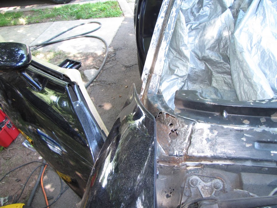

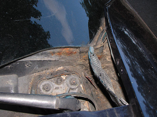

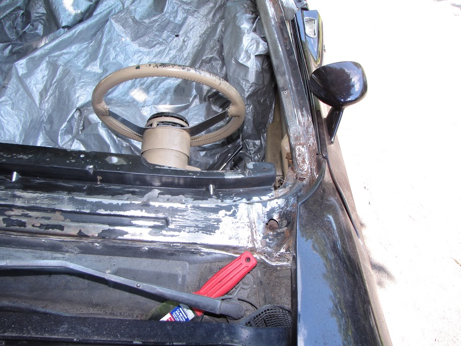

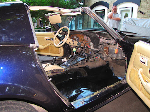

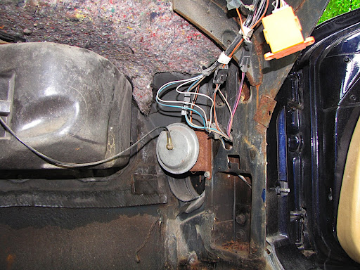

thank you again for your advice. I ll have to take the wheel off to take good pictures of the body #3 body mountrust.
In the meantime, this weekend i was taking the trim out adn noticed the windshield was... loose in some spots.. i got a windshield tool and took the windshield out in 1 piece without a scratch.
Here are the pics of the rust i found. i wish i had took better pics before i started wirebrushing and cleaning the old rust.
the A pilars had surface rust, but was enough get the butyl strip to not adere anymore. so the windshield wasn`t hard to take out.
the center part of the birdcage had VERY little surface rust.
The 2 big holes, im asuming are factory for ventilation ? should they be pluged?
Thanks again !
matt

Well I was right, the windshield was installed incorrectly. It should not have been that easy to take out. It should at least had urethane as an adhesive to hold the windshield in place. Good for you in getting it out "without a scratch".
Your new pictures did not show up, I have seen the interior shots but still need to see that body mount, exterior windshield area. Especially the area at the lower windshield frame corners where it meets at the pillar post/a-pillar.
joewill is correct in some way. If the rust is extensive, and where it is located is labor intensive to correct......sometimes it is best to sell it and start with another car.
I have lost count on how many people I have told that to over the years. Like I had mentioned earlier, it is much easier to replace a rusted out frame, than replace some of the internal birdcage components that are key to structural integrity.
Are you planning on removing the front clip?
"DUB"
I need to see good photo's of the areas the rust has affected.

Matt,
You DO have some issues with the lower windshield area. Good thing is that it can be repaired....but may require further removal of bad steel so a good view of the integrity of the inner steel can be determined. Thus causing further action in rust removal or prevention. both sides are bad not as bad as I have seen in the past.
Before you get to crazy in the windshield area, photo's of the body mount need to be posted whenever you can get to it.
And yes, I do believe it MAY be in your best intrests to aquire some place where the car can be inside while these repairs are being made. TRY not to cover the car in plastic due to trapping moisture like a greenhouse and other areas can begin to rust. I know you got to do what you got to do...but... no need in creating other problems. This moisture can effect wiring connections and if you have exposed body panels without paint, can possibly create issues that can effect the final paint if not taken into consideration.
