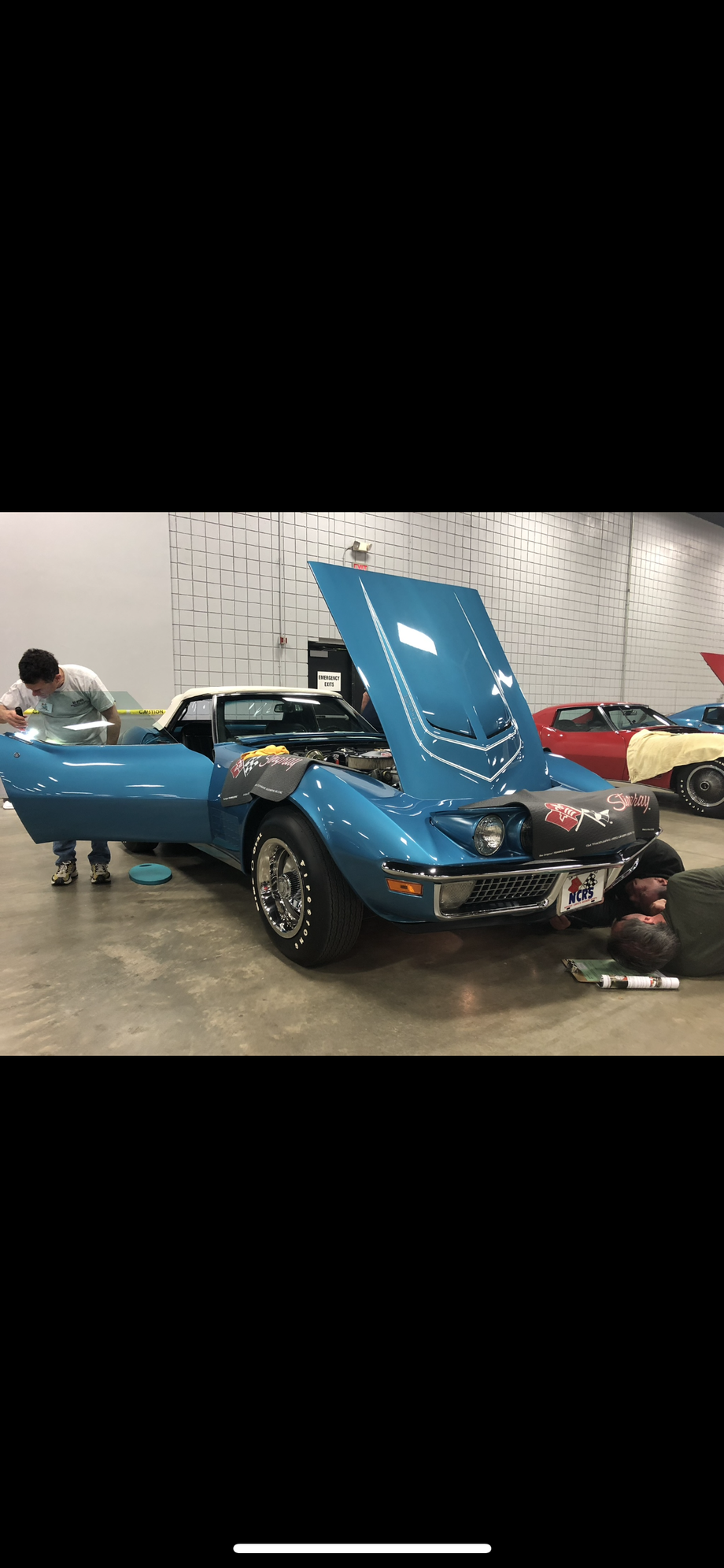

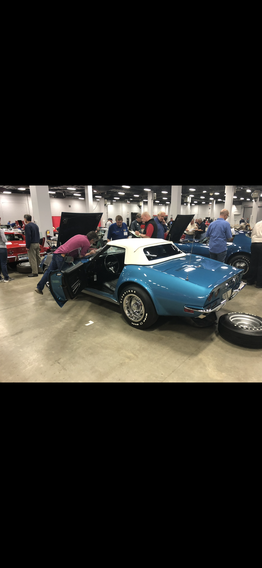

2nd owner 1970 LT1 all original drivetrain. Mulsane blue with black STD interior. 411 rear, tilt wheel, vinyl hard top
