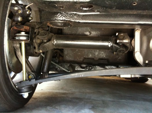

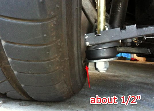

Does this look ok? Rear spring clearance

I am running a fiberglass spring also and after the bolts that came with it caused it to rub the tires I switched to a 10" bolt and then had to cut about a good inch off of the bolt after it was all done.

Originally Posted by c69vete
To the OP. It looks like the end of the spring is inside of the wheel. If the washer size is reduced, you should have no problem, and if you raise the rear a bit more, even better. Not sure about the VBP spring, but the TRW is VERY easy to shorten. Take an inch off each end and no worries.
Originally Posted by Jim_Harrison
I shortened the end of my TRW spring and ground off the washer till I got clearance on my 17" wheels. Been racing it that way for years, no problems.
O man... would love to see some picks of the TRW spring cut shorter... did you re-drill the holes further in also? did you grind them or???
but to the OP... I currently have the TRW on a 79 with stock 15's and had to grind just the lip of the steel that protrudes out... <1/4" then even in hard turns no rub... but it is very close...
O, and I am dropped about 2" and want to go 1" more

You could always order a shortened spring. Get a 1/2" off each end.
On another note, I wouldn't let the end of the spring bolt go below the lip of the wheel. If your tire blows out, your rear end could be next.
