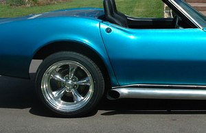

Just swapped out the 6 or 7" bolts for 10" bolts. I am running a VBP composite mono and 18" rims on the back. It seems pretty tight to me, but the geometry looks good. Thoughts?

That's about what mine is (73 Vert)...
BTW - I was told if you use a fiberglas spring - Gas Shocks are required

Well, you asked. I would not feel safe in that car. Why try to defeat GM engineering?

Well I'm not quite ready to jump on the GM-is-perfect-lets-not-change-anything bandwagon but it definitely is too close. After a trip around the block the car settled more and it's too low anyway. Going to have to crank them up at least an inch. I can't imagine these 10" bolts working for anyone...I think 9" is the max, and that might be a stretch.

Consider a flat rear tire... sidewall ripping at the nut, then the nut possibly making contact with the road surface. Not a scenario for me, thanks! I'd raise the ride height and use a bolt which allows rim contact without bolt contact.

I have run the spring below for about 10 years with no rubbing issues. You should be good to go. Yes, it is one of the dreaded TRW springs with too much arch and I am going to change it one of these days.

I think part of the problem is the 18's. It puts the lip of the rim right at the level of the spring assembly.

If you think this is close You should see what happens when You use off set Tailing Arms and then offset the Wheel inward to gain clearnce with wider Wheels. The spring bolt will end up up inside the Wheel and you will have to use the Bolts upside down. In this sinario the Larger the rim diameter the more clearnce you will have. The 10 inch Bolts are not intended to be used at the full 10". Once You have Your ride Height set just Cut the Bolts off leaving enough for minor ajustments. The Full 10" pretty much covers any Spring Wheel or look ajustmet that any one could dreamup.

Thats what I have heard also. Many others with the 10inch bolts cut them to 9 inch. I got the 8 inch bolts and they are not quite long enough to get the ride height I want. I would like about another inch lower, but I was told with the stock 15 inch rims since their is more rubber, the washer may come very close to cutting into them. Guess it also depends on the series (60, 50, 45 40) of tire. Post some pics on once you get it adjusted. Also what size tire and series tire do you have on those 18's?

10 inch bolts, cut down to 9 inch with new 9 leaf steel spring from Mid America with 255-60-R15s on 15x8 with 3.75 backspacing. The trick here is my backspacing give me the extra clearance thats gets me over the hump with a good 1/2 inch clearance.
I have kept an eye on the inside sidewall for any contact. So far so good.

The tires are 27540R18. It looked only slightly better than this with a 7" bolt.
My arm is still sore from cranking the nut up an inch or so. I'll see if I can handle another inch today.

I noticed the angle that the half-shaft has. Can that be a problem?

Alan, I think if anything the half-shaft being straight is optimal. However it did settle a bit, which made the tire higher than the diff. I've got it cranked up to about 2" of threads showing and I think it is manageable now. I hope so. I've had so many problems the last thing I need is the spring shredding the rim or tire.

To the OP. It looks like the end of the spring is inside of the wheel. If the washer size is reduced, you should have no problem, and if you raise the rear a bit more, even better. Not sure about the VBP spring, but the TRW is VERY easy to shorten. Take an inch off each end and no worries.

I shortened the end of my TRW spring and ground off the washer till I got clearance on my 17" wheels. Been racing it that way for years, no problems.

I had thought of grinding the washer, but I didn't think of shortening the spring. That might just be the solution if it won't clear as-is. Thanks!
