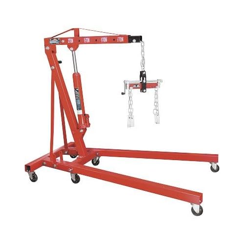

You're right about the removable cross member making it easier, but I was able to do it anyway. It took me about three relaxing hours working alone. (Turn the crank, take a sip of beer, turn the crank, etc.) I just used an engine hoist like the one below. You need to have the engine leveler thingy, but most of the better ones come with one. That's what allows you to angle the engine. I rented the hoist at the local rental place.
Thanks for the reply, I had a feeling you would have used something more than just a standard balance/leveller. I have got to hand it to you, you must have had alot of patience to ease it in there - It must have been very tight, especially on your own where its difficult to watch all corners. I will keep it in mind for future use that it is possible

Rotating the engine to give you more clearance was a brilliant stroke...but how do you do that with just a 'leveler'?
