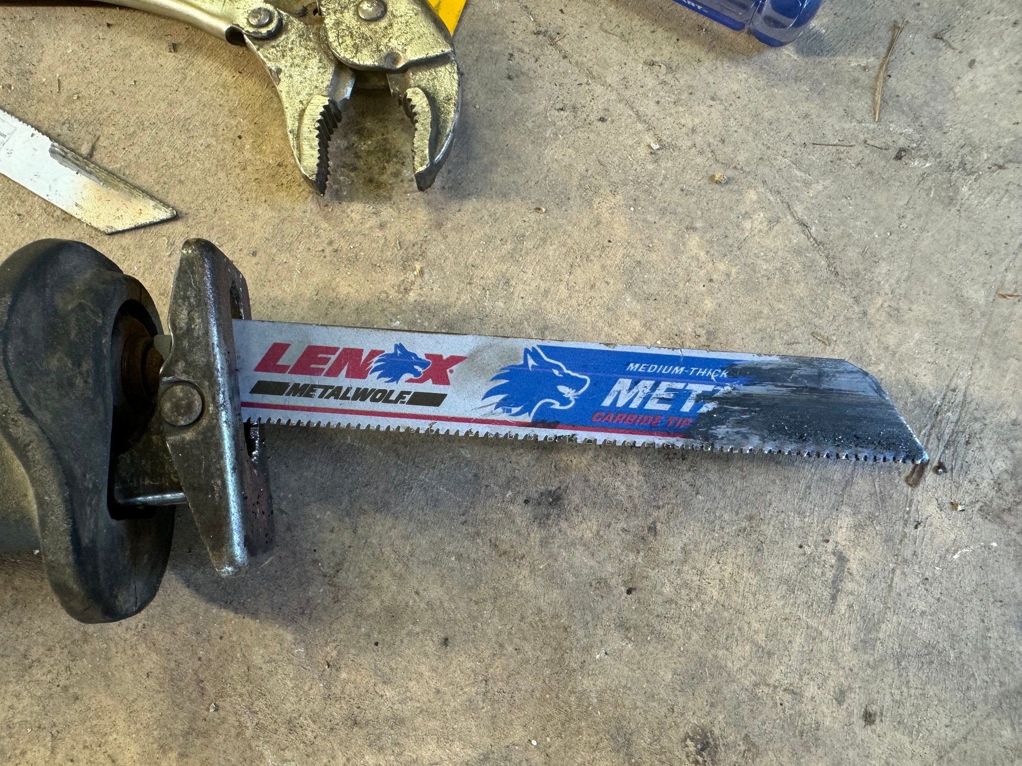

Originally Posted by Gordonm
Sawzall for sure. Get a 8 or 9 inch GOOD bimetal blade 18 tooth and have at it. A 14 tooth will do if no 18s are on the shelf. A little cutting fluid helps a lot also. I'd prefer Lenox blades since I have been selling them for 25 years.
Can confirm. I tried at first with some generic metal cutting blades I had around the house and after struggling for a bit decided to go to Lowe’s and get the best metal cutting blade they had and it cut through the first bolt in about 30 seconds. One blade did all four cuts without issues and the last cut I had to go through, half of the bushing to get to the bolt and still no problem.

Northern Hydraulics carries carbide blades for ur saws all. They out last the other plain metal cutting blades. It takes time to cut thru the bolts so have patience.

Originally Posted by 4-vettes
Ahhh, 14 year old thread! Ya think he's still workin on it? Or maybe again all these years later.
Forum member has problem, searches Forum for answer, finds it in 14 year old thread, and posts an update that it works. We should encourage this feedback!
Good job @ScottEwine! I had similar results with a different brand of carbide blade when I did this 6 years ago.
