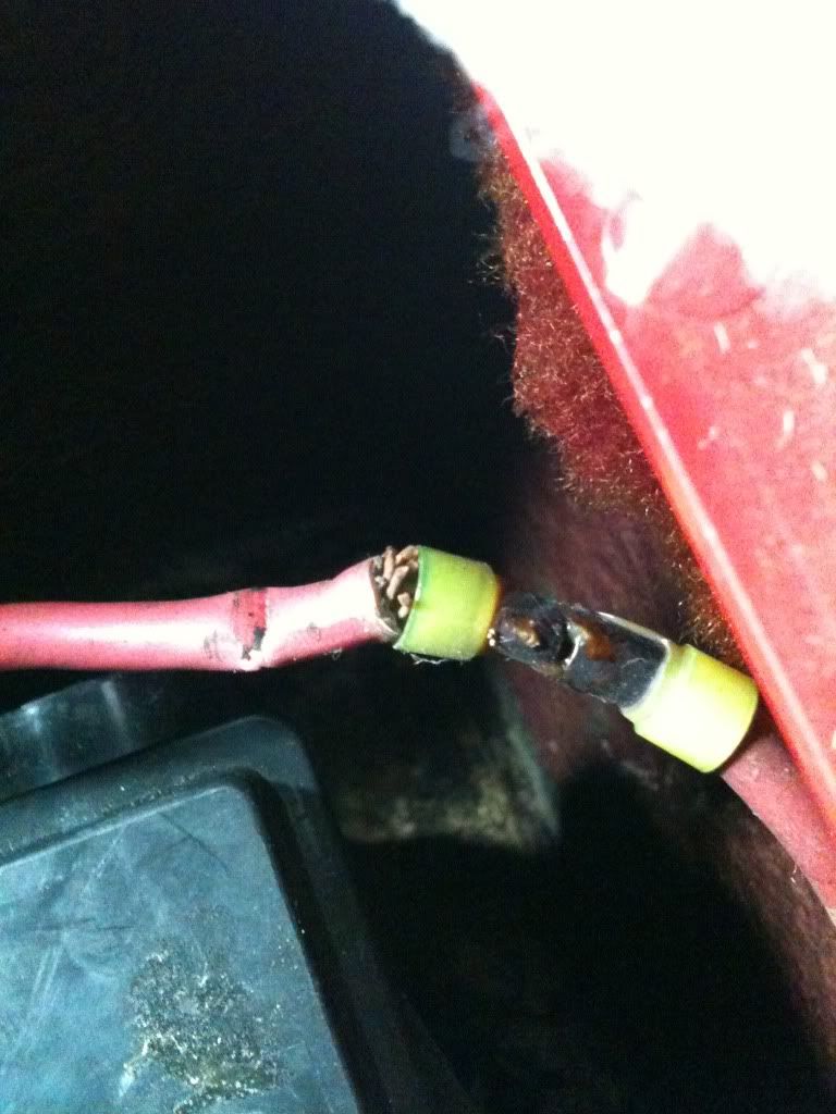

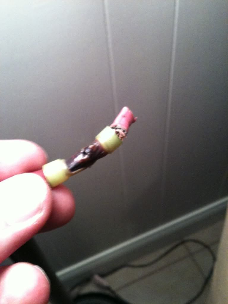

Replaced the Neg(-) cable. Had battery tested, checked out great with heavy load.
Then I started thinking, maybe it's the neutral cut-off/safety switch. But, as I was reconnecting the battery, I got a large spark which got my attention ...so I started tracing the positive cable, which initially looked fine, and I found:
AKA: BUBBA?
I'll replace tomorrow and hope this is it!

Old Apr 10, 2010 | 01:47 AM
OMF's Avatar
OMF
Joined: Jul 2006
Posts: 2,268
Likes: 480
From: Salmon Arm, BC
You really have to wonder about that BUBBA
Old Apr 10, 2010 | 09:59 PM
7T1vette's Avatar
7T1vette
Posts: 37,637
Likes: 3,113
From: Crossville TN
Yep. A low amperage butt connector on a high amperage wire. Hmmmm... Either get a proper splice connector or solder it.

that connection may have been a fusible link temporary fix at one time that became permanent

Old Apr 11, 2010 | 05:00 PM
GridIronMac's Avatar
GridIronMac
Joined: Dec 2007
Posts: 85
From: Cedar Creek Lake Texas
I temporarily joined the wire together and still having the same result. Just a 'click' noise at the battery.
I have found a ground wire that is exposed and will fix that also.
I am just concerned that the problem lies elsewhere....
Are there any fuseable links that I should check?

Old Apr 11, 2010 | 07:06 PM
7T1vette's Avatar
7T1vette
Posts: 37,637
Likes: 3,113
From: Crossville TN
I don't know how you "temporarily joined" those wires, but if you didn't solder them or use a connector that bolted the ends down tight, the connection probably isn't any better than that chintzy butt-splice piece. You are drawing a lot of current through a relatively small wire; the wire shouldn't be spliced at all. Solder it up, before you give up on it.
Old Apr 11, 2010 | 08:13 PM
Mark-Ia's Avatar
Mark-Ia
Joined: Mar 2009
Posts: 35
That looks like a very small positive cable. You might want to think about replacing it.
