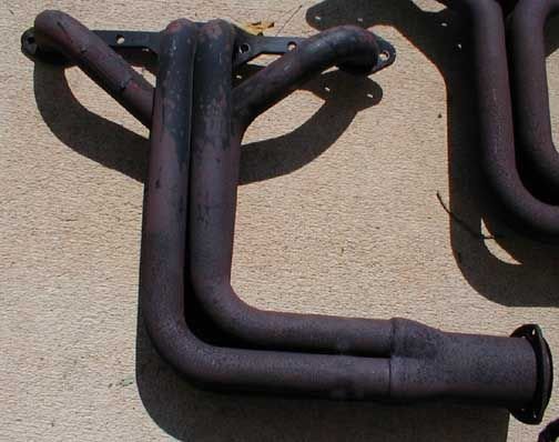

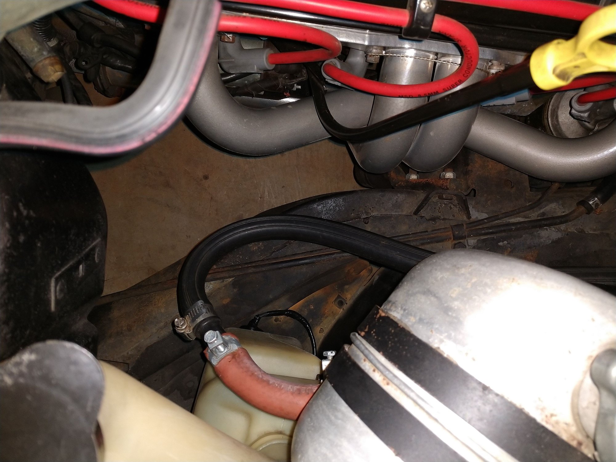

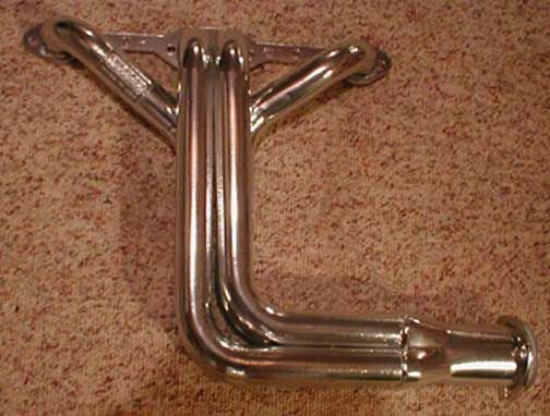

I had my Headman headers Jet Hot coated in 2002, daily drove my car for almost 3 years from 2016 to 2019 after putting 20,000 miles on it before 2016 and my headers look just as good as the day I installed them with the JHC. Yes the shiny dulled a bit but they still look good. Not sure about other ceramic coatings but Jet Hot is the only way to go in my book. Jet Hot coats inside and out. I can tell you 10 minutes after driving I can pretty much grab the header without burning my hand. Yes, it's that good. The headers I had coated were about 2 years old, a little rusty as the stove pipe black was burnt off before I sent them in to have coated. If you already have a set of headers send them to Jet Hot. You won't be disappointed.
Before:
After
And in this picture you can see what they look like with about 30,000 miles on them:

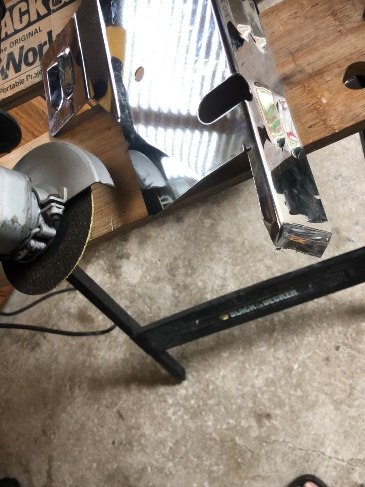

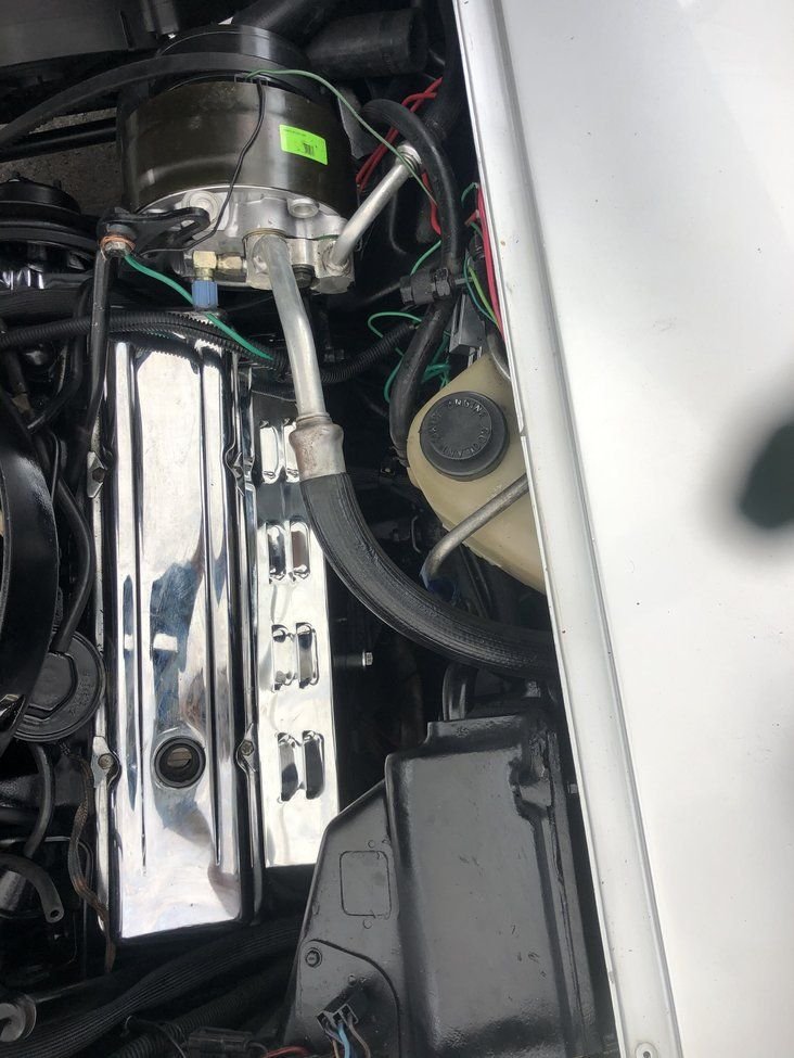

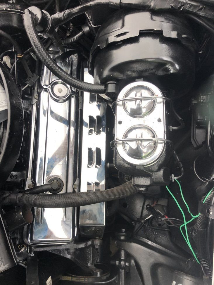

Default exhaust manifold covers
i kept everything original with the manifolds. just bought these cover. had to cut them with a cut off wheel. look how good it look IMHO. cheap on ebay but came from ecklers.
