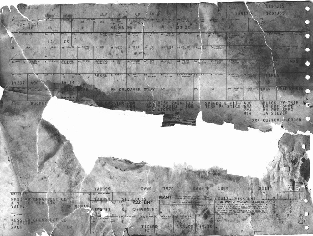

I was changing out my sending unit tonight, and since I had the tire carrier off I decided to reach up and see if my build sheet was still on top of the gas tank -- sure enough it WAS!
The bad news is that the paper was so old and brittle, it started falling apart the minute I touched it. Also, the glue was still holding on so a big section in the center didn't come off.
The GOOD news is that I was able to assemble 80% of it (thanks to a high-res scanner and some time in Photoshop) and the paper and ink was quite legible. Actually, it was in really nice shape.
I wrote out what was in every box (those are the numbers). The sections in parenthasis () I'm not sure about, so I'm guessing.
I'm hoping some of the experts here can help me decode what I have, or at least fill in some of the (?) areas. Thanks in advance. Sorry for the long post but here goes:
JOB SEQUENCE
C10(3)8(2)36
SCHED DATE
62- 51(4)
11-16
2. (?) Key
3. COMP KEY
4. ENGINE ID
CLA
5. TRANSMISSION NO.
CK
6. (?)
AW
8. BODY NUMBER
10382(3)
VEHICLE IDENT. NUMBER
1Z37J3S
11. AXLE
AW
15 FRT. SPRING [RH/LH]
MA / MA
16. REAR SPRING
(E)A
26 ENG.
LA
27. TRANS.
CK
62. H/LINER
Color
64. SHELF TRIM
Holes
75.
WS
76. MODEL
1Yz37
77. TRIM
400
79. COLOR
LW - 14
UP - 14
80.
BRKSW
90.
TIRES
94.
(?)LCG
95.
WIRE
105.
LPSW
106.
RADIO SPK
107.
A51 BUCKET
?? Carrier
??? ENG
ORM GR70X15B 2+2W
u69 AM/FM Radio
(Y)K3 FRT LICENSE-M
Z12 Speedo $ Fit
1GB Tire PR Stick
400 Black VY Trim
6MA LH FRT SPRG
7MA RH FRT SPRG
914 14 Silver
109. CHARGED TO
Kessler Chevrolet Co
A Street Box 476
Vale, OR 9791(?)
110. Shipped to
Same as above

The following info is from Vette Vues Fact Book 1973-1977 M.F. Dobbins.
4. CLA= L48 w/Turbo Hydra-matic trans
5. CK= Base engine Auto 17,927 produced
6. Axle # AW=3.08 ratio
9. Vin 1Z37=Coupe, J=Base Eng. 3=1973, S= St. Louis
box 24 is combined w/ 9 should have DP Seq. # rest of vin???
11. AW=3.08
76. 1Yz37= Corvette Sport Coupe 25,521 produced
77. 400=Blk Vinyl
79. (9) 14 Corvette Silver Metallic
Thats all I can interpret.
You should buy this book, it is a good one.

My buildsheet is REALLY big. You can download a smaller version of it here
www.albertpenello.com/vette/1973buildsheet.jpg
Silver 73 -- Thanks for the info on the parts I'm missing!
