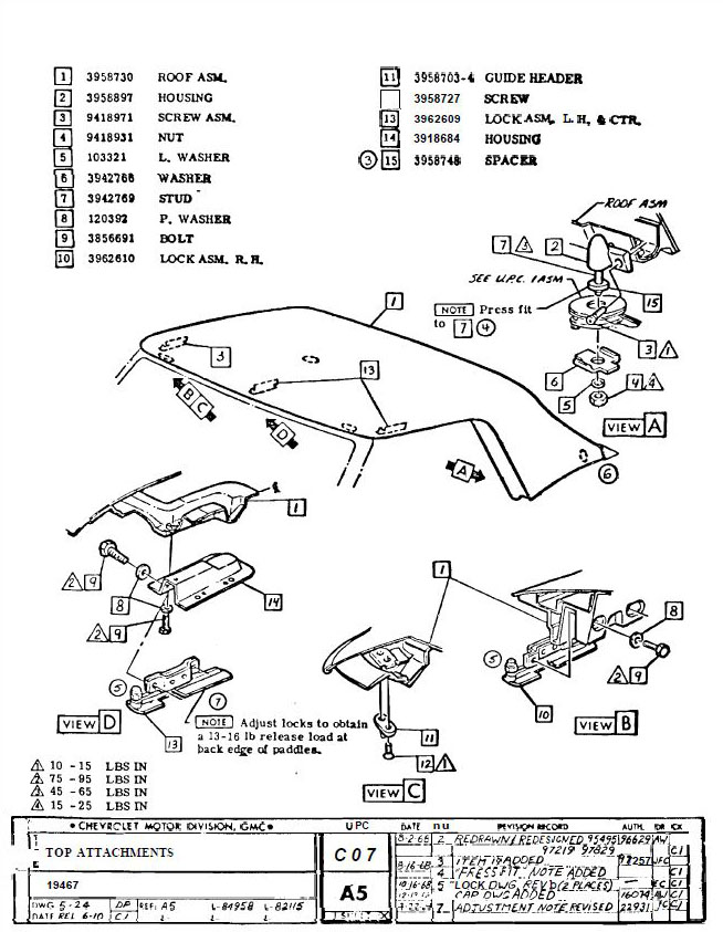

Here is the 1969 AIM page showing how the HT mounts at the rear:
Hope this helps,
Pete

Originally Posted by Drizzle
I've had mine for 2 years with the soft top pins on the hard top (the way I got it). are you saying that they didnt use those from the factory? Did they use a stud with nut originally?
That is interesting if so, and would explain why I never thought it sealed like it should.
Yup, I have three hard tops and all attach with studs, very large washers, and a retaining bolt. Depending upon the year model there's also a smaller center bolt to pull down the top snug to the deck ( this actually works quite nicely ).
