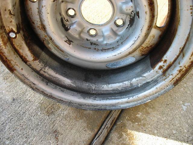

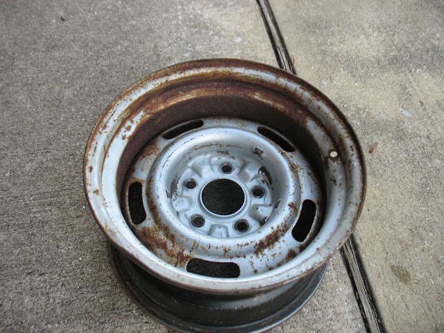

I'm very happy with the results.
Before -
After soaking overnight -

Wow that silver section on the bottom is where you soaked it ? Did it remove all the rust, it sure looks like it, it almost looks like it was painted silver
Yep, sure was. It is supposed to only remove the rust and not affect the painted areas. This seems to be the case as all of the black paint on the back of the wheel was rusted. Some silver painted areas on the front of the wheel look unaffected on the third picture as they weren't rusted.

Also, not spoil your party, but the wheel appears to be bent. In the top photo look at the lip at the 7 o'clock position.
No, that's an area of rust.
