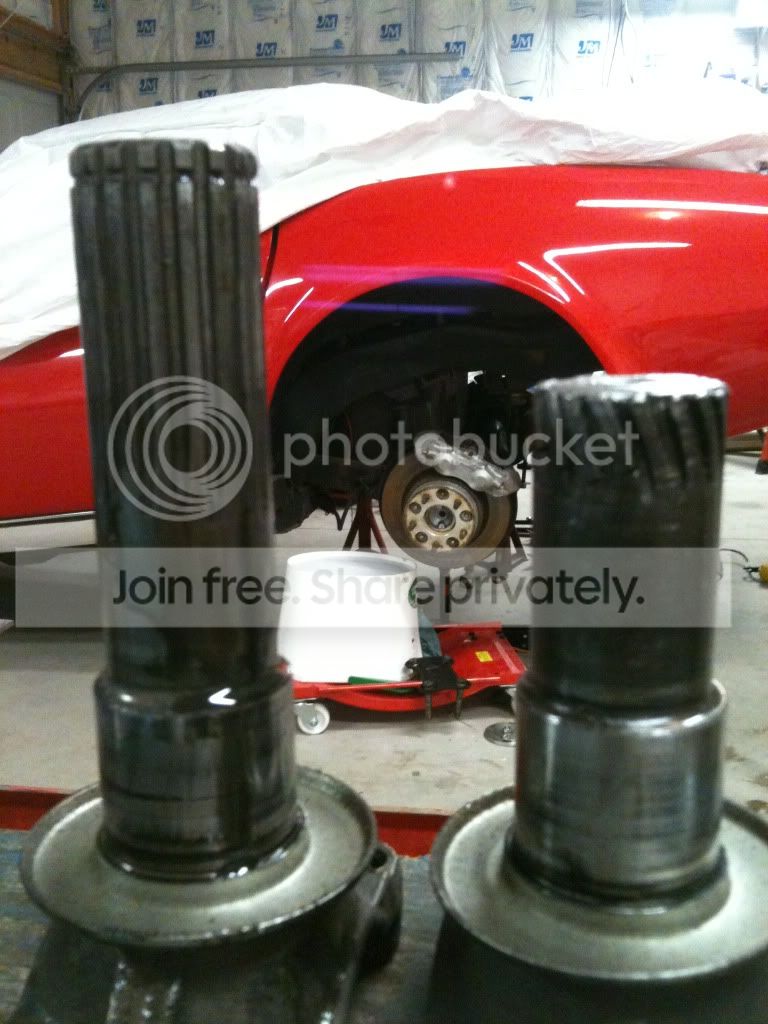

And now the axle stub! I found out these babies are hollow half through from the yoke end. I don't know why they would be that way???

Don't even consider running 17 spline stub axles regardless of what they are claiming. With the power you are making you will twist them. Add to it that you're running a standard trans greatly magnifies the shock load. You cannot run 400 lb springs without using the non-engaging carbon fiber clutches. Which is a moot point since you should not be running the preload springs at all. They are to aid the clutches in low load situations hence the name preload.
You've also gone past the Super 10 option. The carrier won't handle the load and shock for very long. In your pic it looks like you have lost the front pinion bearing which is why the carrier is chewed up. Looking at the next to last pic I can see that your clutches are shot and the spider gears are worn out. A rough guess is that you have at least 4-5 times the maximum allowed spider gear backlash.
To do the 12 bolt conversion you will need a lathe, a mill, and a surface grinder. There is a tremendous amount of machining that has to be done just to make the parts fit. The carrier shims have to be made, the original design won't work. You also need to ugrade your driveshaft to 1350 joints. Those 1330's won't last long. Next to go will be the outer spindles and the the halfshafts.
