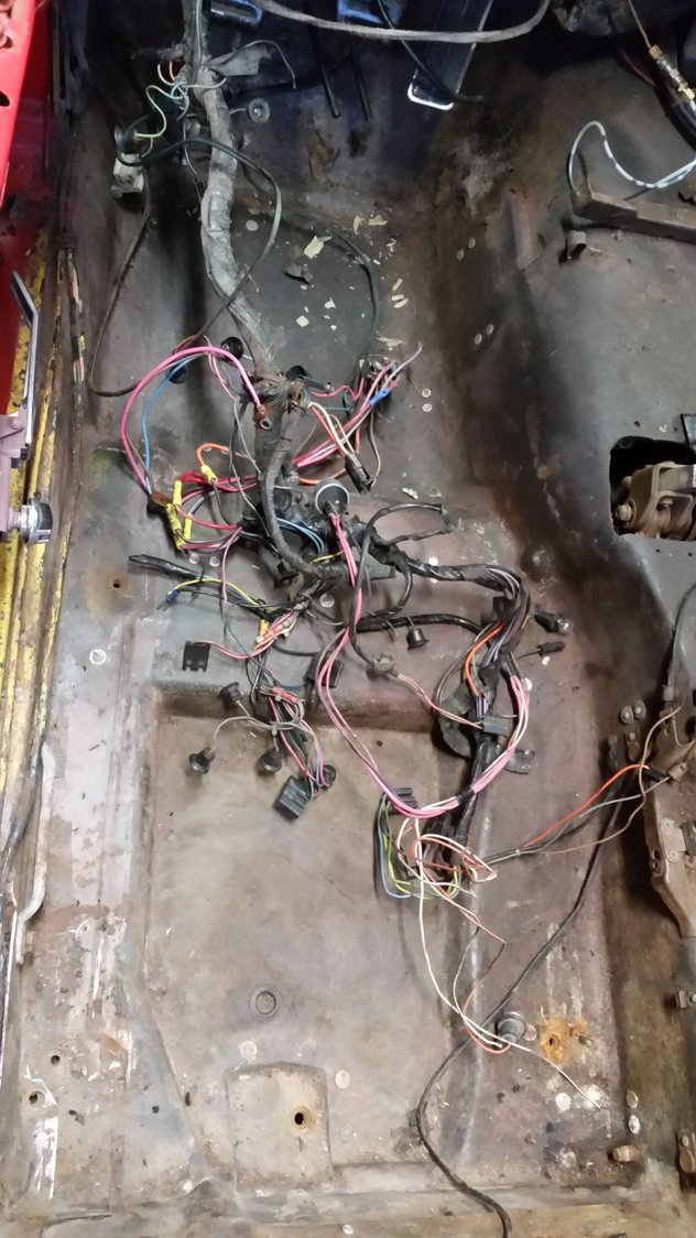

Lots of cut wiring. Just going to rewire everything. everything.
Wiring

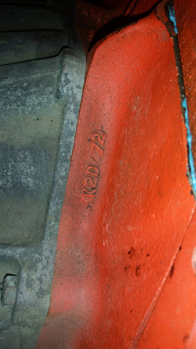

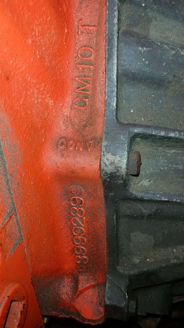

Doing some research on what I pulled out.
casting #3999289<br/>2 bolt main 72-78 car & truck.
Date code I assume. So Nov 20, 1972?

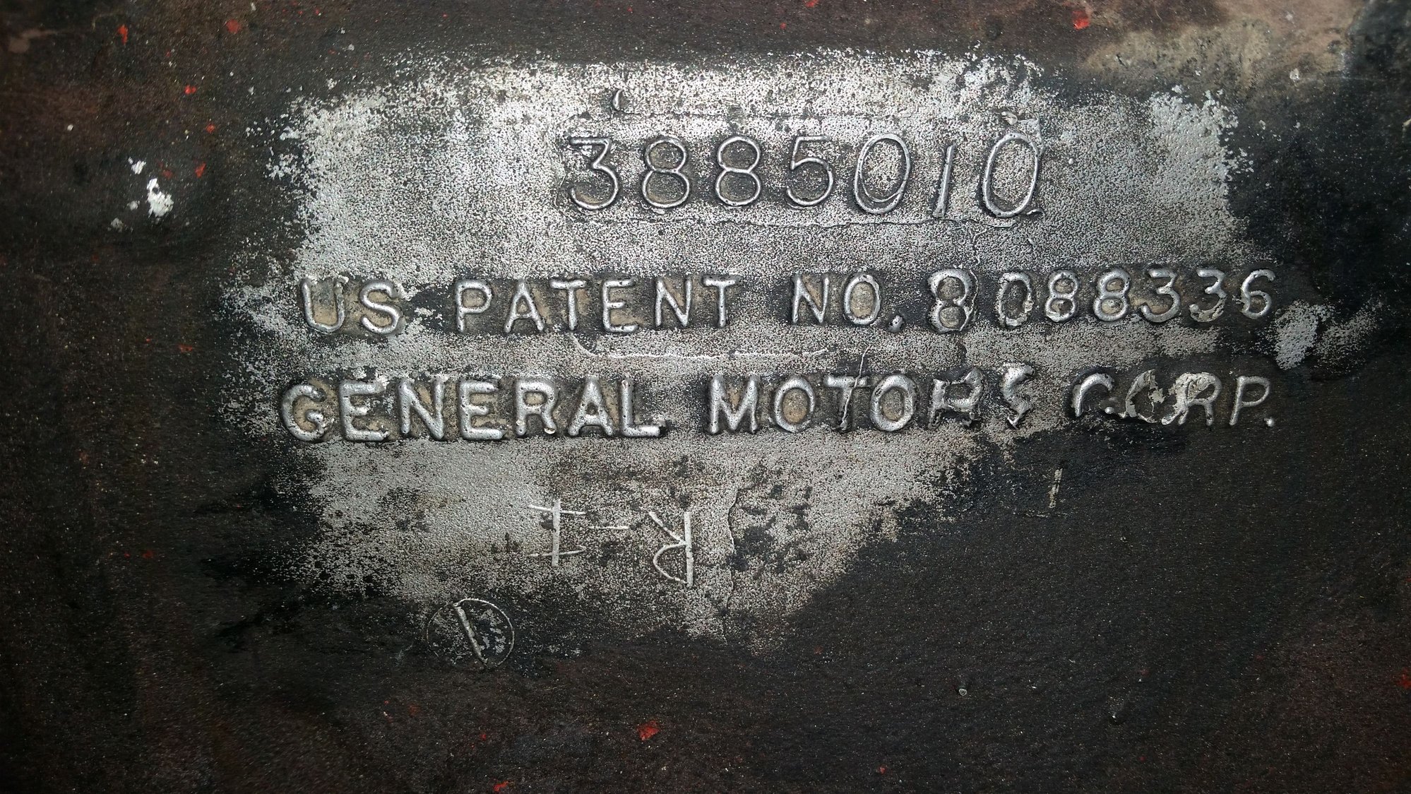

Case casting 3885010<br/>Identified as a 66-67

I'll have to clean it up and find the rest of the codes to identify the block further. The guy I bought it from also had a build sheet for when it was rebuilt, guess I can hunt that down and take a look at it. LOL.
Trans is a bit more confusing. Seems someone took an older Muncie case and rebuilt it with the later stronger stuff. I counted the output shaft splines and it is indeed 32 spline.
The only way to finish identifying the trans is to disconnect from the engine, and I'd really prefer to sell them as a package still connected.
