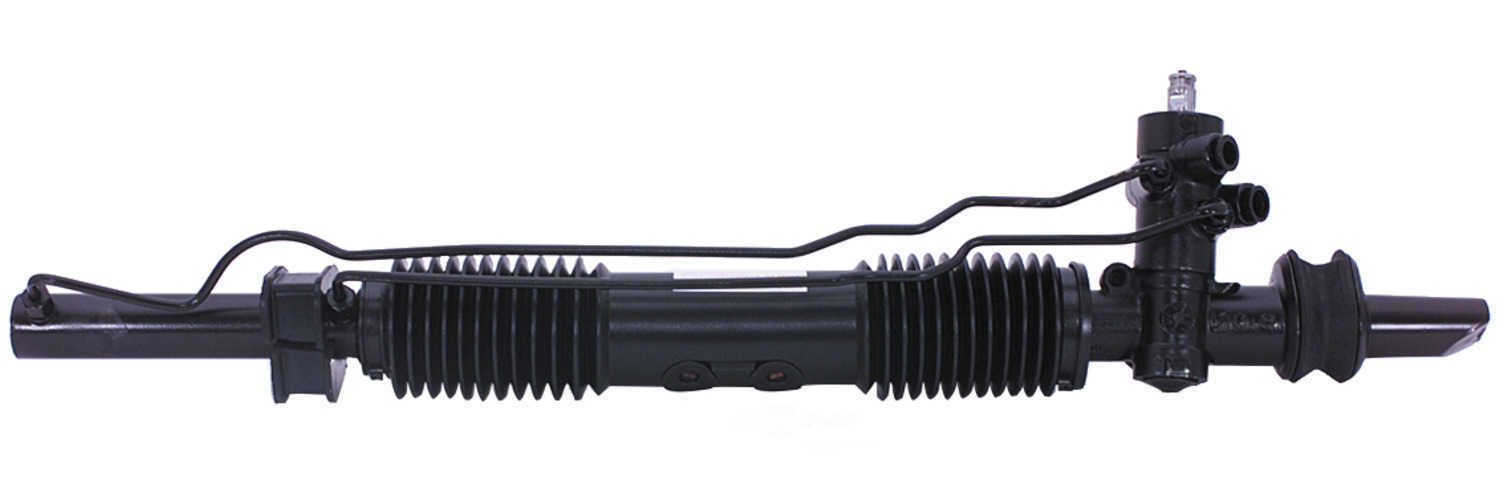

Has anyone else had problems with this?
Based the instructions, you just add the mounts and install it into the car.
On the passenger side, there is a small pipe that runs along the top that directly interferes with where the mount goes.
Is this common, are people just bending the pipe?
Jerome

What pipe are you talking about. You just remove the idler arm and use the 2 bolt holes there and mount the bracket in the same location.

They hydraulic line on the rack and the rubber bushing/mount

I have installed 5 of these on various year C3s. Never had this issue. I can't picture how yours is in the way. Something is not correct. Any way you can post a picture of it?
My car is not here but I did look at a picture of one I did about a year ago. I see what you are talking about now. Yes just push the line up and out of the way a little. It may have gotten slightly bent when shipped to you.
This is the one you are talking about. The picture is a little off due to the angle of the camera. It is close but not rubbing anything. That part of the rack does not move so it can be a tight fit

You just put the rubber mount under the line and attached the clamp, the hard hydraulic line was not in the way?
If so, then I do have a problem, the hose is about an inch from the rack where I need to attach the rubber bushing
I'll post a pic as soon as I'm in the garage.

My rack looks like the one on the top
