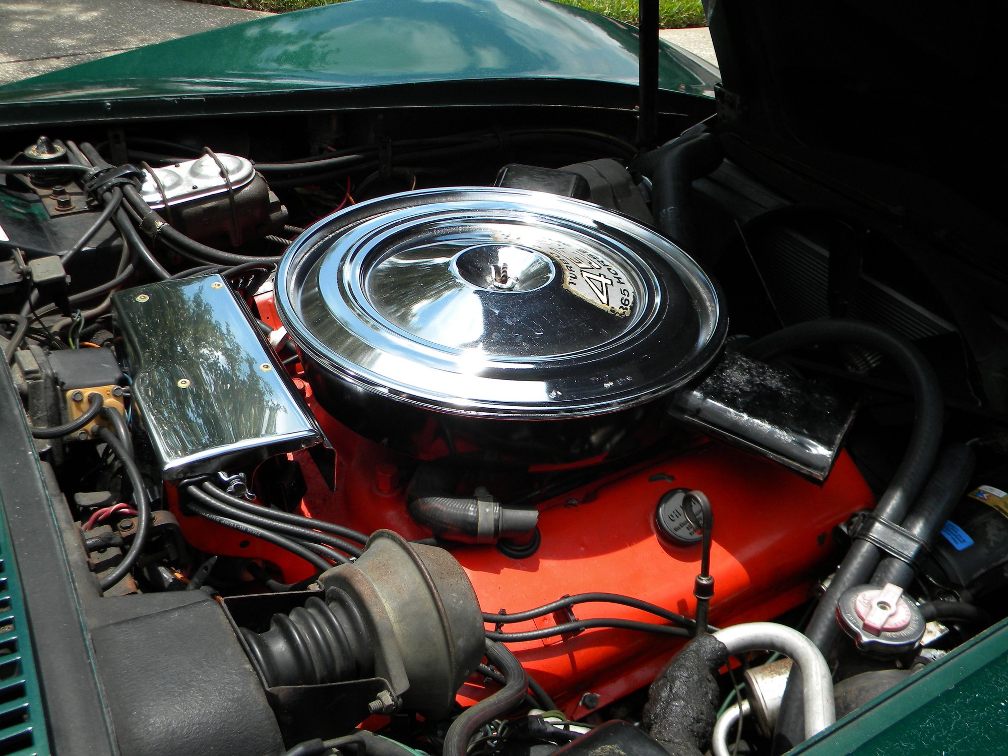

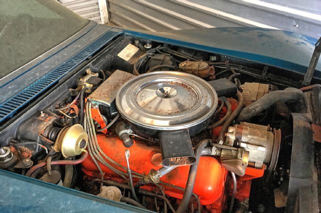

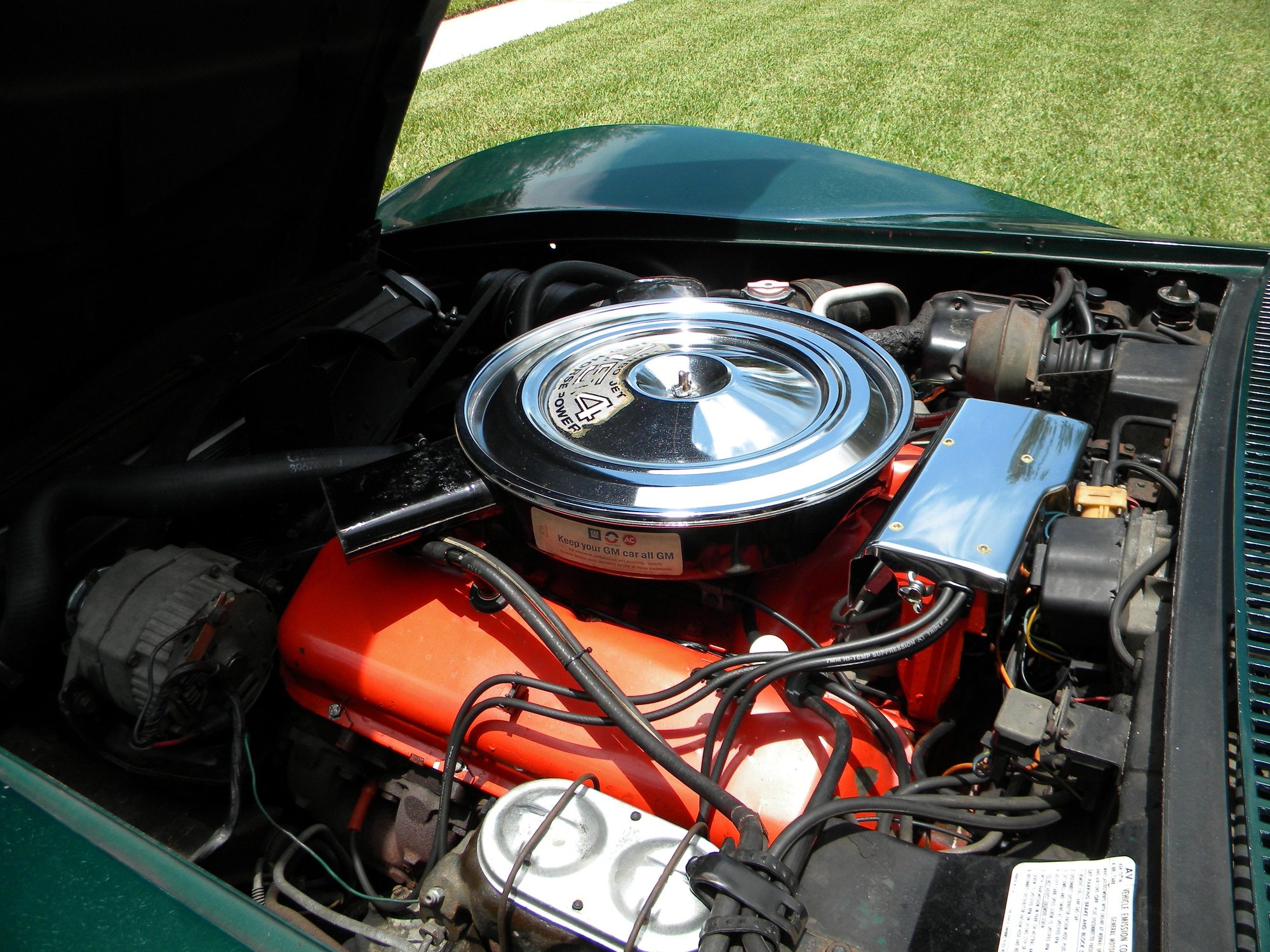

ou are in luck I have been saving engine glamour shots for a while.
I found 3 pics for you:
This is a very nicely restored 48k mile 71 LS5 that has the two wire clip in the center of the pass valve cover near the carb stud. Interestingly the driver's cover does not have this clip on this car.
The second pic is a 72, this is a 900 mile! (duh) untouched original and you can see the four clips near the bottom valve cover lip, one for each plug wire. It also has a clip in the middle of the valve cover, but it holds 4 wires, is further back, and is on a 45 degree angle.
This third pic is a 2 owner car, he owned it since it was 4 years old. 55k mile, unrestored but very well maintained 71 LS5. No air holes in manifolds. But missing silver shielding on plug wires. Correct plug wire clip in center of valve cover.
