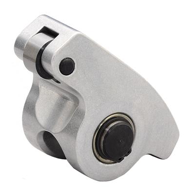

Suppose you left the cam alone and simply installed 1.6 ratio rockers and new valve springs?
What do yall think?

I think its waste of money. Install the cam for the build and use. As for a good intake a Performer RPM, Weiand Stealth, Holley Street Dominator (LT1) copy can fit under the hood with the right air cleaner. I suggest pull the intake and a head to see what pistons are in there so you can do an accurate compression calc and choose parts from there.
