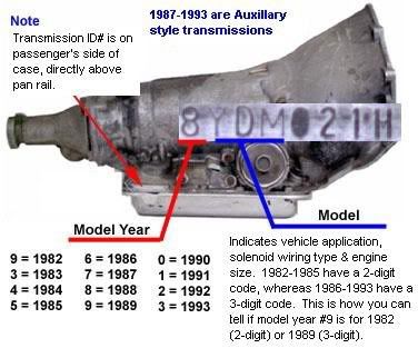

Not sure if this helps. I used this determine the year for my late model core I upgraded too.
[IMG][/IMG]

Thanks, Rebelrob, that will help with the identification effort. I also found out that the 'green' speedo drive gear in this tranny used to be blue (changed color with age and hot oil). It is an 18 tooth gear. I will have to change it to a 16 tooth gear to get the right speedo calibration.
