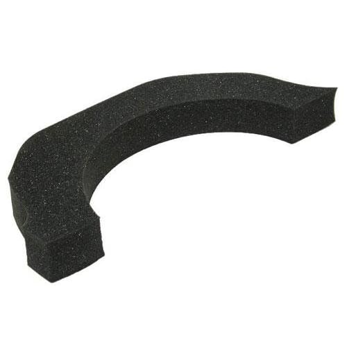

You might want to check and see if your car still has the "transmission tunnel foam collar heat shield"- between the transmission/bellhousing and firewall. Often removed and not replaced. This will also help big time in cooling your interior.
Richard
