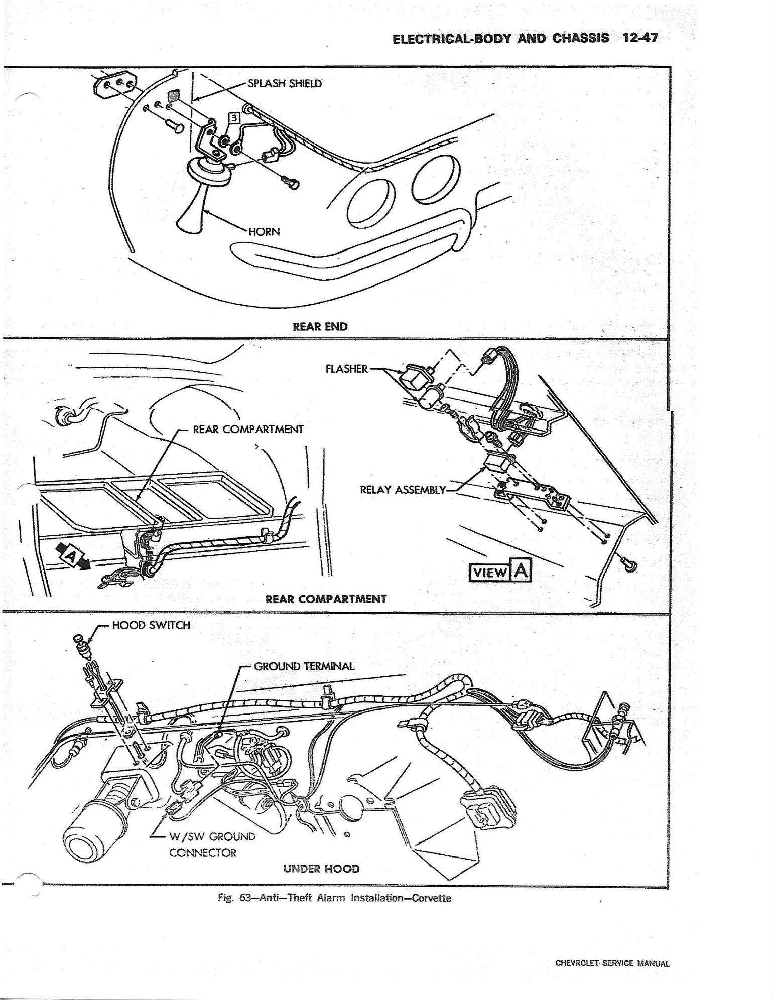

Here's a schematic if you need it.
Here's where all the parts are:

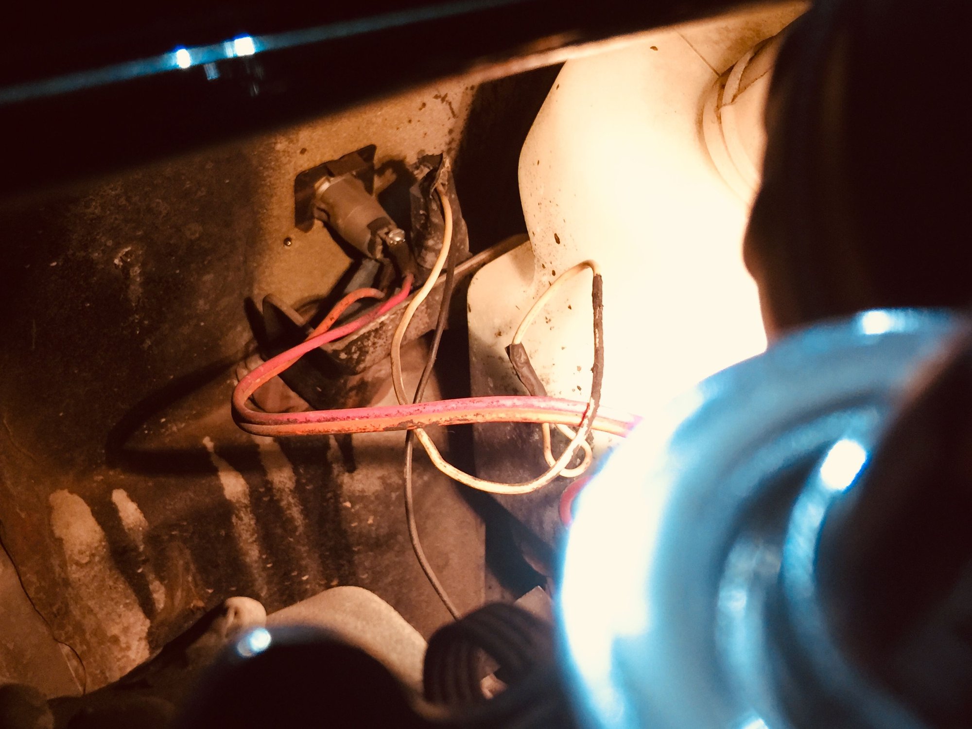

all connections are secure all switches seem good the only thing is the yellow wire Here is a shot from the inner wheel well the yellow has something to do with this??
