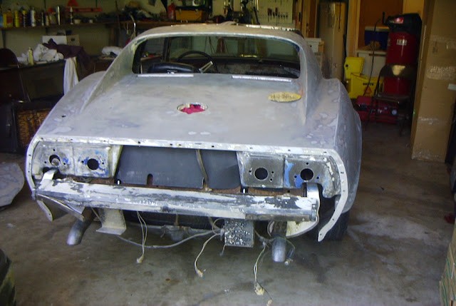

For me, I used all three methods. For the large areas I used razors. For the tight concave curves and detail areas I used stripper. And everything gets sanded eventually.
No matter what method you choose, you are going to have to sand eventually. The image below details very important prep work. I recommend getting some help.
I blocked the whole care three times and still cringe years later when I hear woman with an emery board.
