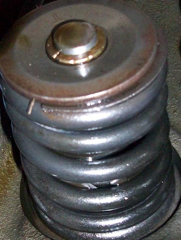

heres a couple pix, after thinkin how much time and money ill have in gaskets, r&r, and cleanup im leaning towards replacing the springs only. its those terms like coil bind and seat pressure that worry me though...

So it's a broken inner spring on what looks like a pretty stock engine with the exception of headers and what? based on that and you not wanting to throw a bunch of money at this old dog, buy one of these:
http://www.ebay.com/itm/KD-912-Valve..._Tools&vxp=mtr
It works real well for me on any head that has studs and it's cheap. Use compressed air (easy) or the rope trick (little tougher). depending on the location of the affected spring, you may have to remove the carb or misc. parts to get a clear shot. Use a small magnet to capture the keepers and buy a set of valve seal o-rings while your at it.
This one is not my favorite and it's more money, but others have used it with some success:
http://www.ebay.com/itm/KD-2078-Univ..._Tools&vxp=mtr
If it is fairly stock, you won't have to worry too much about the spring pressures, just get the same length & style of spring and you should be fine. Now on your new engine, your going to have to educate yourself so you don't end up with a pile of incompatible parts!

got the 2 broken springs removed(yep found another one), talked w the machinist nearby, he agreed no sense in spendin the money at this point since im planning a build. got the new springs from him, got them installed. will finish her up tomorrow and go from there.

bummed one of the crank type spring compressors, and did the rope trick
