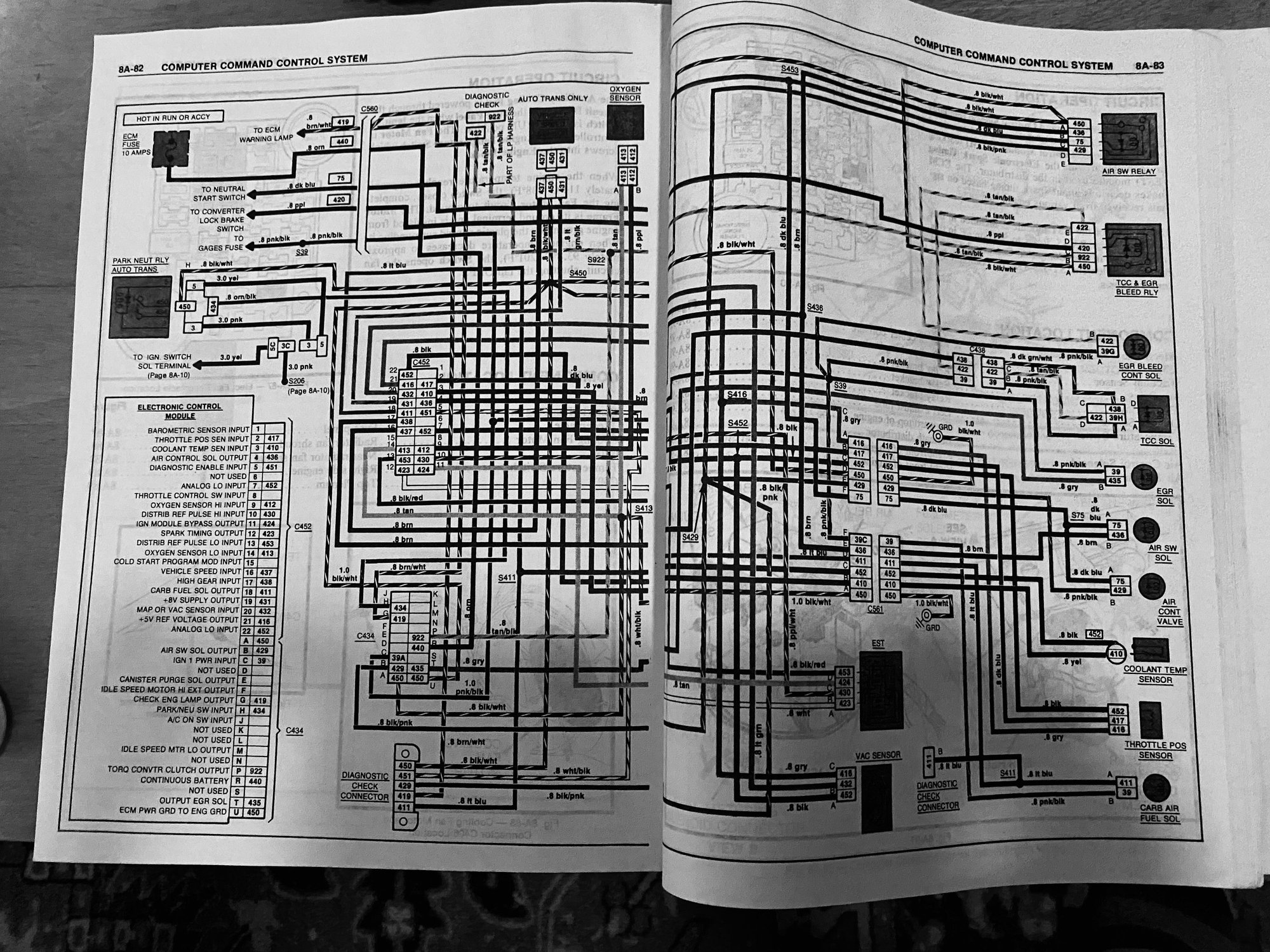

Hey everybody. This is my first post and Im new here because well i just bought a 1981 corvette. The car is in pretty good condition but it sat for a long time with poor weather stripping. I have replaced the tires, weatherstripping, radiator, fuel pump, plugs, distributer, all the bushings on suspension, belts, gaskets on oil pan and headers, oil change and fixed a broken gas sender unit. ugh. so last thing I thought I was going to have to do was have the Carb rebuilt, which I did. it drove amazing for like 45 minutes. It started doing the rough idle, stall out, wouldnt shift out of the highest gear. So I did a ton of research and it looks like I also have a bad ECM. I just bought one today and was lucky enough to find one available. I am not ready to get rid of the computer system as I want to do a full LS swap in the future instead. I will make sure to keep the original prom chip and install it correctly. This car is pretty stock, ac doesn't work, and neither do the high beam, right turn signal dash indicator lights, but they function outside the vehicle. Oh and the coolest thing was there was an original 1981 corvette shop manual in the car in a plastic bag! I wish I could scan it for yall!. Im also tackling the headlight vacuum relays. I didnt realize it needed this much work but I got a really good deal on it, it belongs to my best friends dad who sadly passed and they offered it to me. After doing the bushing I have a negative camber on my rear drivers tire I need to address.
Im glad I found this site, I would never have guessed it to be the ECM.
