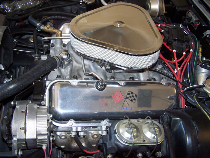

so guy's whats the best after market alternator to buy, would also like crome

What type are you looking for (1 wire, ext voltage, etc...)? Also Amp rating?
Any mods on your car to make one not fit you can think of?

you have a collectable classic car, keep it that way.
remove and rebuild the orginal alternator, they look just fine cleaned up.
No reason to go to 1 wire alternator, they do not work as well,
because they have no voltage sense connection.
you can rebuild with higher output if you run lots of electronics.
