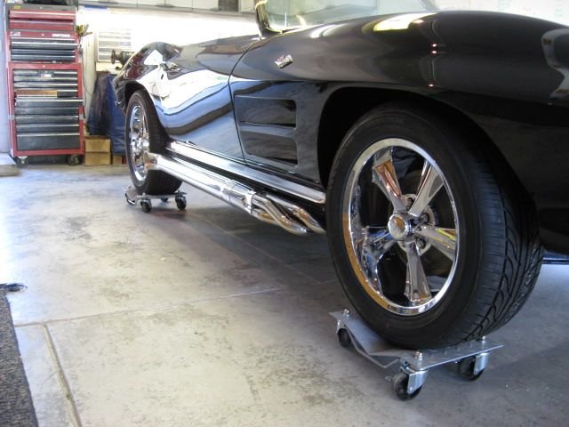

The Hooker system looks very good when mounted – don’t get me wrong. The point is that the installation, “tweaking” and mounting can be a tedious process requiring more than a few wrenches and a screwdriver. I used a Port-a-Power, concrete floor anchors, a chainfall, floor jack, hammers, a drill press, tap-and-die set, and a ton of patience and fabrication ability to remove and install the headers 5 times before they fit right. The sidepipe mounting hardware supplied was junk and did not allow alignment of the sidepipes, so I fabricated all new mounting hardware including thick, ¼” stainless threaded frame inserts and adjustable stainless mounting studs to interface with the supplied rubber cushion mounts. Here are the final results:
Here are the headers mounted to the engine after being “tweaked” a bit:
The sidepipes were mounted on custom made standoffs to make the pipes run level and parallel to the frame rails:
So, after an extensive wrestling match between me and the Hooker SuperComp Sidemount Headers & Sidepipes as outlined in this post, I have finally managed to get the system installed on the car, eliminate all the interference points using a Port-A-Power, floor anchors, a chain fall, and 2 hydraulic rams, I have fabricated custom sidepipe standoffs to get the pipes parallel to the frame, bent the collectors to equalize the height from left to right sides, cut my rocker panel moldings, and polish them out along with a little painting. Here are the final shots of the end results:
2 more days of cutting, tweaking, and polishing of the rockers produced the finished product:
Sidepipes installed with modified rocker moldings – moldings were cut, sanded and polished on the top surfaces, and given a satin black epoxy coating below the polished surfaces. This accented the polished pipes nicely. The adjustable pipe mounts were used to make the pipes perfectly parallel to the modified rockers:
