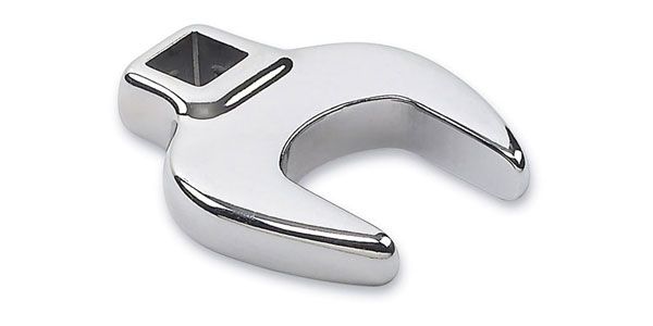

I have always used a crow foot wrench. Mine is Snap-On but I'm sure Sears sells them too.
