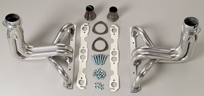

I've been using these for many years. Hedman 68280. They dump out toward the side exhaust at the exact angle to connect to the stock side exhaust muffler.
No clearance issues, steering box, clutch cross shaft, motor mounts, etc.
You still need to cut the stock side exhaust muffler pipe and weld on the collector.
http://www.hedman.com/site/?d=119&dt=108&Keyword=68280

If you want to stay with headers, McJacks sells a set that are meant to hook up to sidepipes (looks like they are the ceramic coated version of the Hedman Hedders Barry's70LT1 posted):
http://www.vetteheaders.com/servlet/...orvette/Detail
http://www.summitracing.com/parts/HED-68286/?rtype=10
Thanks Barry, looks like the way to go. Not afraid of cutting or welding to get the right performance, sound, and look.... Rob

Good stuff, glad I asked before I ordered the factory setup. Can't tell by the description on Summit of Hedman, but the McJacks are 1 5/8 tube diameter, a the Hookers are 1 7/8. What are the Hedman's? (Guess I could just call and ask).
Many thanks...Rob

I used Hedman side exhaust Jet-Hot coated headers and stainless steel Sweet Thunder early C3 style sidepipes on my 80'. I have the fiberglass covers, but haven't installed them yet.

Sweet Thunder in Michigan builds the factory style side pipes without the tube from the header to the muffler allowing you to fabricate your own. These are made for those that have aftermarket headers.
I just installed the facory style side pipes on my 81 with the stock manifolds, they sound incredible. Can't wait to get it back on the road and hear them while driving after I finish the front seal, balancer and pan gasket job.

I have Sanderson shorty headers and Sweet Thunder side exhausts. Had a local muffler shop connect them up. I was concerned about restriction in the exhaust when I bought the mufflers so I went with ST's bigger diameter units. They work well but when I pull into the garage it rattles the glassware!

Hedman also makes the side exit style for Big Blocks. I have them on my car. They fit great. I have the painted version and they were about $149.
I checked these this morning. The price is $185. The part # is 68210

The painted Hedmans are a good deal but you will probably have to take them off and paint them every couple of years. You might consider the coated version of those Hedman Hedders. It's another $290 but they hold up longer and the coating cuts down on engine compartment heat. They are listed as 68216.
