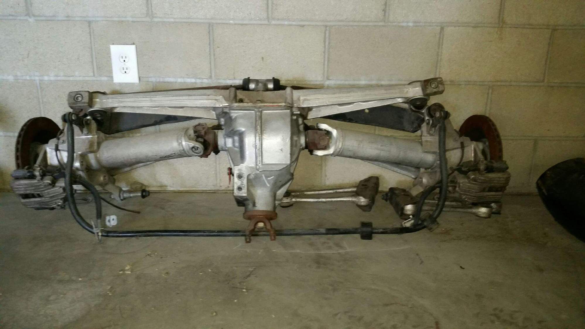

Old Feb 6, 2018 | 02:44 AM
Mr___Bob's Avatar
Mr___Bob
1st Gear
Joined: Feb 2018
Posts: 1
Default I am trying to determine year of this rear end assembly and third member.
Last edited by Mr___Bob; Feb 6, 2018 at 02:47 AM. Reason: Additional info. Only numbers I see are 18214 and 42861. And on torque tube I see 14041 and 925-AR D173.

Probably from a C4. Have you posted there?
