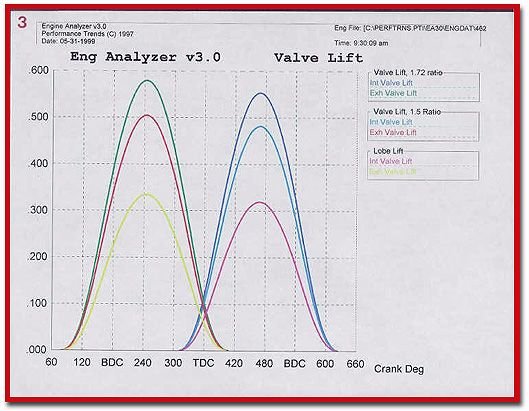

Originally Posted by toddalin
You're wrong.
Duration is always measured at some given lift (e.g., 0.05") and that lift will always be achieved earlier and held later using a higher ratio rocker assuming nothing else changes. The change in duration may be small, but it is there.
Yep!
WCC Josh, look at the diagram. (Yea I know it's a Pontiac, but the effect is more pronounced with the jump from 1.5 to 1.72 ratio.)
Because the seat-to-seat duration remains the same but the valve opens further it means the valve also opens faster, which increases the duration slightly at all the points in between closed and max lift. -This is why switching to higher ratio rockers usually moves the torque and HP peaks upwards ever so slightly. (Watch that Engine Masters Season 2 Rocker Ratio episode again and pay attention to the RPM peaks; if duration didn't change, the peaks wouldn't change; only the torque and HP would change if duration wasn't affected and it was ONLY lift that was increasing with increasing ratios.)
My 227/228 @ 0.050" cam becomes much closer to 230/232 @ 0.050" with 1.6 ratio RRs.

Originally Posted by NewbVetteGuy
Yep!
Adam
Durations can be measured at lifts of 0.05", 0.006" and 0.000". What's the duration @0.000"? The same for 1.5 and 1.6 ratios and any other ratios one may choose. Area under the curve @0.05" lift with a 1.6 ratio has the "effect" of a slightly longer duration. So, WCC was not wrong when duration is measured at 0.000".
