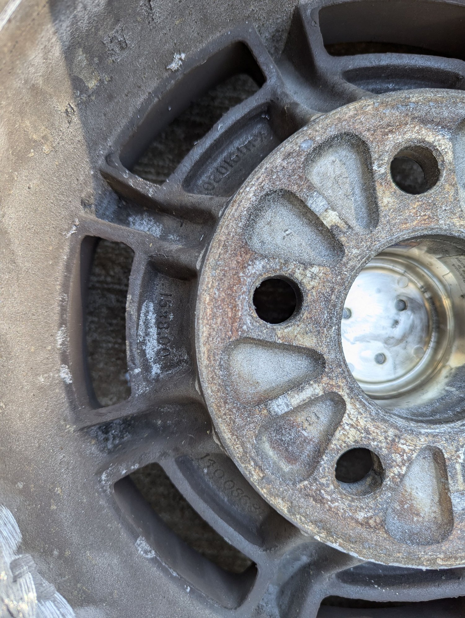

Old Oct 6, 2024 | 04:47 PM
Pipes111's Avatar
Pipes111
2nd Gear
Joined: Jul 2017
Posts: 2
12 years later, having the same fun.
1980 with stock wheels
Rears both fit fine and Driver front fit fine. Passenger front required 3/8" spacer AND grinding on the wheel.
