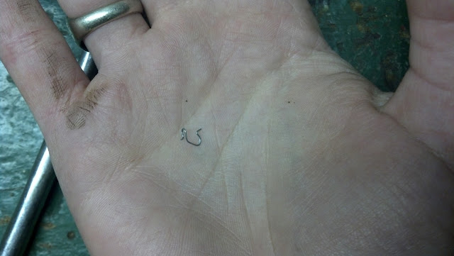

I get down to the float bowl, and I see this sitting down in the bowl:
Now, I could be wrong here , but I seem to recall that this piece is important, and does something, and should not be sitting down in the float bowl. Here is another shot of it once I fished it out:
Could it be? Could this tiny, tiny piece be the cause of all the problems I've been having? If so, I will be LMAO with all the headaches this has caused me. If not, well, let me know so I can get a full rebuild kit for this carburetor. Actually, I might just get one anyway.

that is supposed to connect the float to the needle valve, was there any fuel in the bowl when you took it back apart?

that little clip connects the float to the needle, when the level in the bowl gets low, it pulls the needle valve open which allows fuel to refill the bowl, it's a good bet that you were starving the motor for gas. despite popular opinion, the pressure of the pump will not always push the needle open to refill the bowl

The wet carb and puddle of gas in the intake doesn't really lend itself to a diagnosis of fuel starvation. Maybe this clip wasn't the cause.

I agree that part looks like the clip that keeps the needle on the float, but it seems to me that its more about keeping it together during assembly. If anything it would lift the needle when the float drops. Worst case scenario is that the needle wouldn't raise when the fuel goes down in the bowl and you would have a fuel starvation problem which clearly you don't have. I think you're looking at another problem. My best guess is you're not getting spark. Either not strong enough or not timed properly. Possibly the rotor is out of phase, or the wires aren't routed correctly, but I'm betting ignition problem. If you've got compression, and you obviously have fuel, its got to be spark.

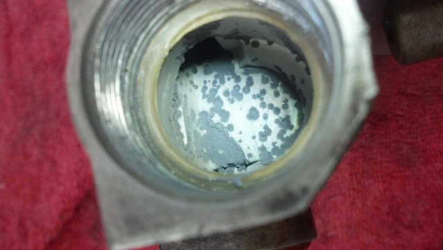

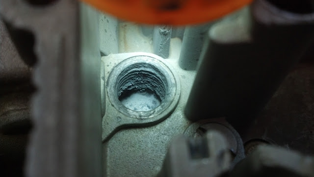

Back to the carburetor, I think I may have found another piece to the puzzle. I decided to put the carburetor back together with the pin and see if magically that fixed things. The first piece I go to reassemble is the needle seat. I screw it in, but when I go to tighten it down it just spins around and around. I unscrew it, and this is what I find:
It looks like all the threads on the carb end of the fiting are stripped, and it looks like it's corrosion that did it. I took off the fuel filter nut and shone a light down in there, and this is what I found:
There appears to be corrosion of some sort in this end of the fuel path as well.
If the seat wasn't seating, and just spinning in place, that means there was no seal with the gasket, and plenty of room for fuel to be leaking past the threads, The needle wasn't doing anything, so fuel was constantly pouring into the bowl, and it was probably overfilling, which caused the flooding, correct?
Also, what could cause this, and more importantly, is there any way to fix it? I'm really hoping this doesn't spell the end of the carb, but I'm not seeing a way around it. The needle seat itself is in fine condition - looks almost new.

If the needle and seat are failing to control the fuel coming into the carb you should see fuel flowing freely down the throat of the primaries due to over filling. So yes if that is failing to seal then flooding would ensue.
Your carb is not necessarily toast. I think some epoxy might fix your problem. Marine tek, If memory serves, is the stuff to use. Lars would know for sure. Epoxy hole a bit, just fill the threads a little and run a tap in once it's dried to put some threads in. A little bubba but would probably work.

I found this product:
http://quadrajetparts.com/rochester-...ads-p-209.html
And am thinking of giving that a try, since I don't own a tap and die set, a heli coil installation kit, or have easy access to a machine shop. Have any of you had success or failure with these types of fixes?

Good find. Looks like it should do the job to me. Drill carefully it looks like a snug fit and a nice round hole may be important.

Information directly from Lars on this issue:
The only way to repair the stripped inlet seat is to do a machine repair helical insert. This is a high-risk repair, since it's possible to destroy the sealing surface during the milling operation if that casting has become brittle. I don’t use [the press-in repair seats] due to poor reliability and high warranty claims. I run about a 75% success rate at the machine repair with helical insert process.
I'm leaning towards sending the carb to Lars now to see if it can be saved.
