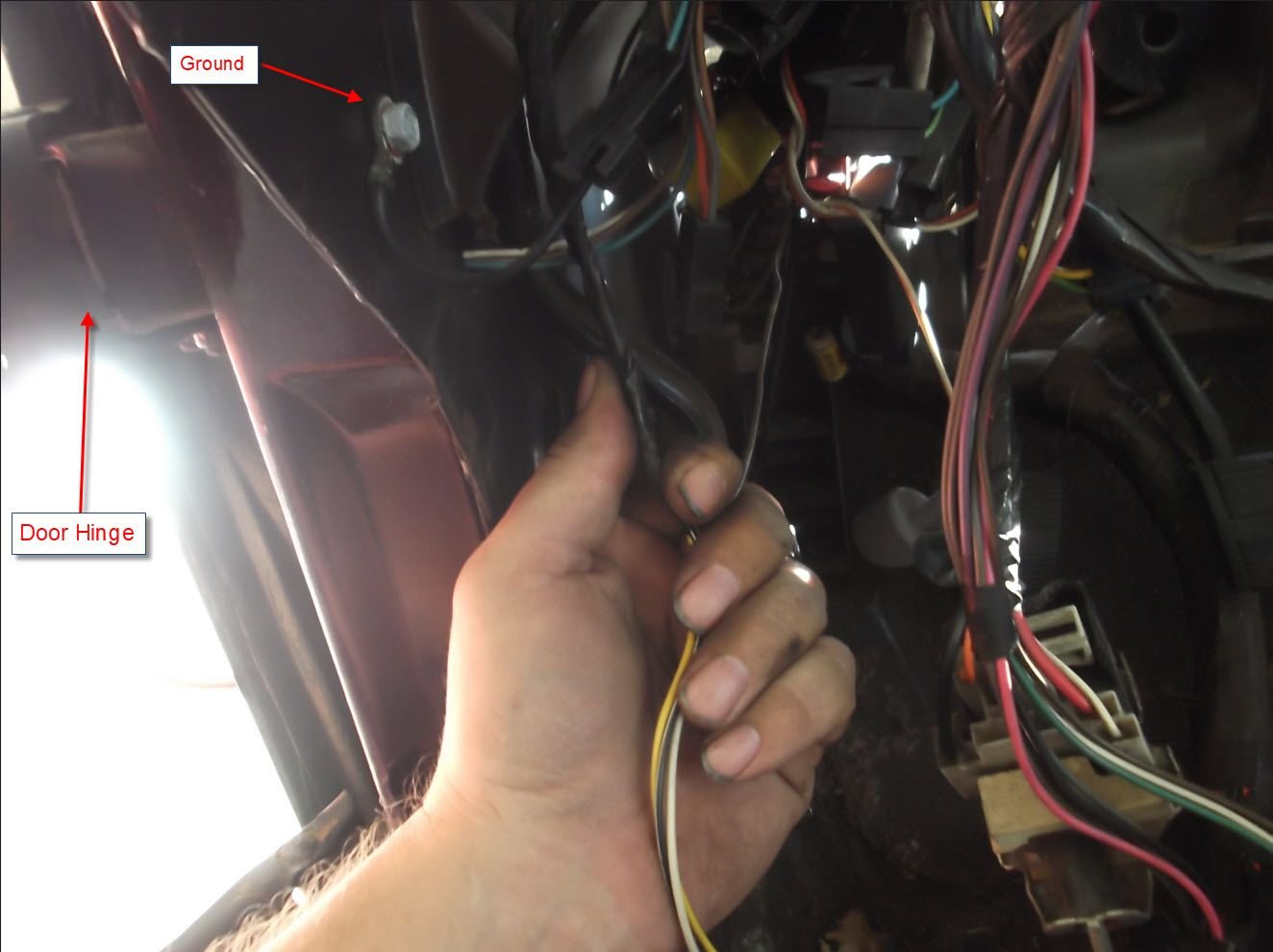

I think these pictures show the ground you are referring to.
These are from my 1981

Thanks for showing this,the ground I was looking for.
