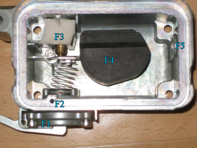

Found an older pic on my website, showing the inside of the bowl:
I pulled the center carb today, opened the bowl and found a very little piece of rubber inside. Maybe this was the reason and it stuck between needle and seat. Must be a piece from the fuel line.
After that i wanted to rise the level a bit in the rear carb, because it was always a bit low. So turned the nut 1/4 turn and started the pump to see if everything was tight.
Then the rear carb was floated! This sucks. Well i turned again a little at the nut and tried it again, then it stopped floating.
