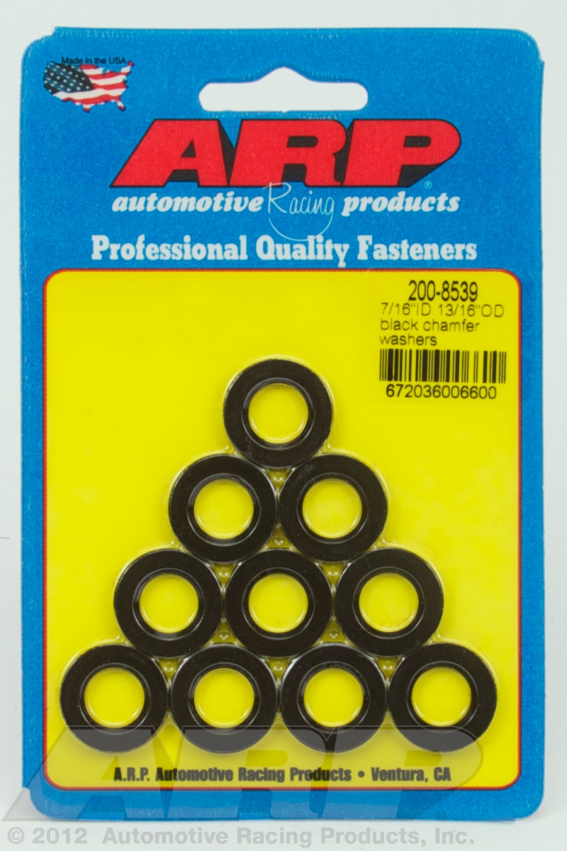

Right then, what you need are these -
http://www.jegs.com/i/ARP/070/200-85...oductId=752061
They say they are chamfered, so hopefully on the other side of the washer is a chamfer which faces up to clear the chamfer on the bolt.

Hold fire, it looks like the chamfer is on the outside according to Summit's pic, you need an inside chamfer.
http://www.summitracing.com/parts/ar...8539/overview/
I'll keep looking....

yeah summit's pic I think is incorrect. Their description says inside chamfer: yes
ended up ordering them from here: http://www.jegs.com/i/ARP/070/200-8539/10002/-1

Good stuff, yes it was a stock photo throwing us
http://arpcatalog.com/i/7/800/200-8539.jpg

I guess I wasn't thinking. they ship those in packages of 10. I ordered two packages. :facepalm:
Apparently I need to call Jeg's...
