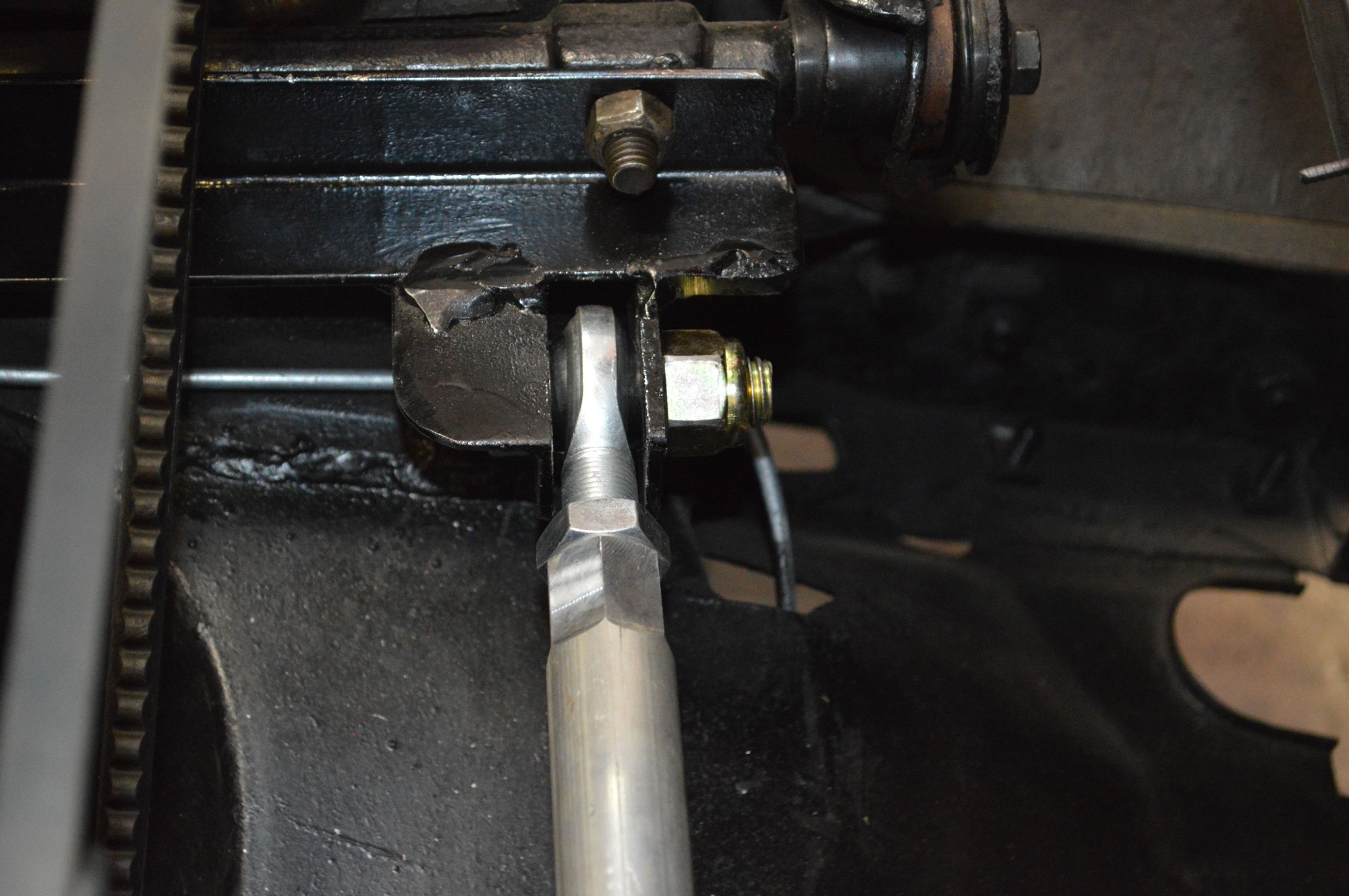

TCracingCA- I may go back and replace my mounting brackets with ones similar to your design. I have some spare aluminum channel iron that is the correct width, so I would just need to cut to length and taper it to make it pretty. Plus- polished aluminum looks nicer than painted steel.

Aluminum in that size would flex to much!

spreader bar brace. one ugly weld shows
Thanks for the compliment!! I thought I had went thru the forums and deleted most all of the pictures of any of my unique mods! I guess I missed this one, as it was on C3! I kind of wasn't wanting the track crowd to see my $hit, till I kicked their a$$es! I haven't over the years hung out on C3, but I think I am the person with the most resurrected posts on C2 (I am retired on there now, and super rarely on C3 now)! I spend time now mostly exclusively on PRC and do searches of my most recent posts as to where I left off over there, or as to what people said after I replied to a topic and then see like an old topic show up in the current is how I see these post resurrections!
I am glad you like my unique engineering! One of many unique ways I have modified my cars! I race Canyons and not smooth part friendly tracks (well I have done that too, spent time on tracks! !). I am an old Mulholland and Turnbull Canyon racer! I have been modifying Corvettes now for over 40 years!
One day, I hope to be done with the current projects, and then you guys can see more of my fancy unique ideas (maybe )!! But actually on the current, I have the same idea, but multiple holes for moving the bar fore or aft ! I have like Clogged Gilmer pulleys with toothed belts and cannot run the flex fan with that set up at higher rpms because of harmonics, so I have plenty of room for the cross brace and not just to the towers only!! For street op, I run a quick release coupler for the flex fan and can put it back on for stop and go driving and can pull it off to remove it fast for maintenance or racing. The brace won't fit with the flex fan, so I have to put the spreader bar back on for the street! !
Originally Posted by TCracingCA
A big block really can benefit from a spreader bar, but you would have to engineer that in on a big block. Fitting one on a big block car is more difficult than a small block. Thus some guys actually cross brace the frame at points below where a spreader bar mounts.
This is when I was running solid uppers, how I had my spreader bar engineered, before switching to the SPC's
TCracing- wish I had seen your design before I fabricated the spreader bar brackets for my 68 BB. I used angle iron and welded the tabs for the Heim joint attachment point. Yours is much neater. RA
