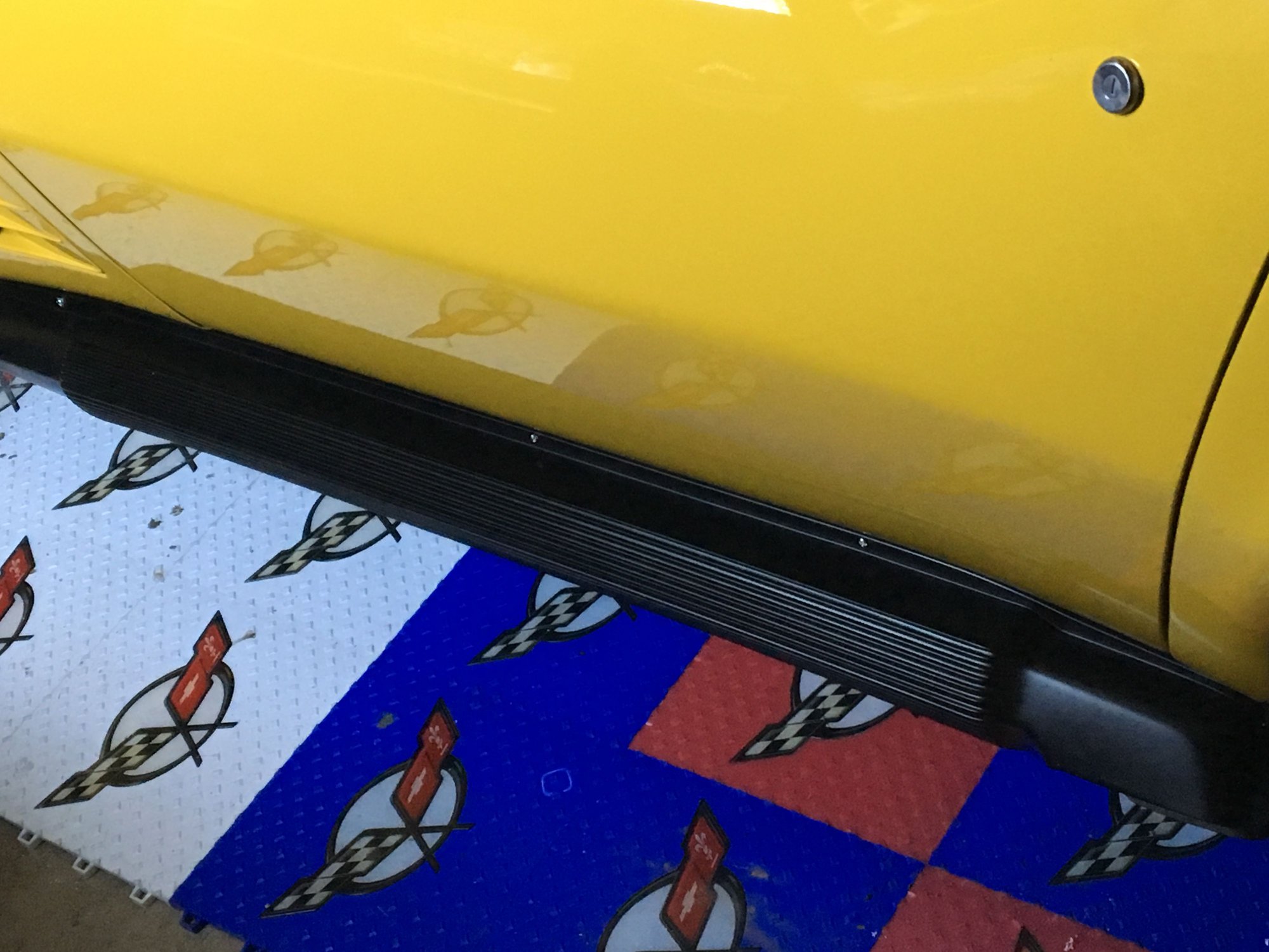

Here is my 72 with the fiberglass covers. I painted them black using Krylon 1613. They have insulation on the inside. Mine came from Allen's. I am very happy them but I still will get a OEM set one of these days.
Joey

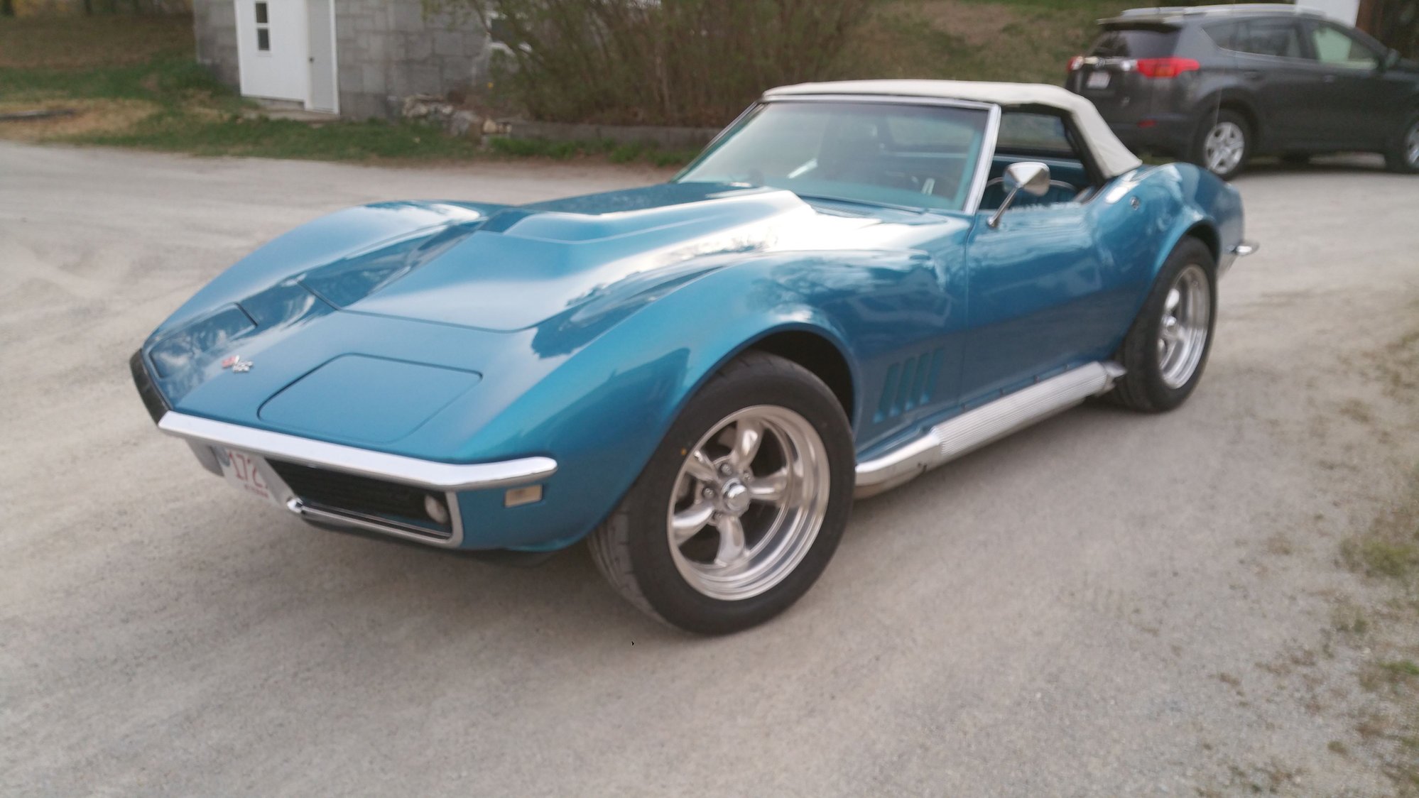

Well I think I like them.

that was fast. Good job!

Hi Bg,
They even sound good in the photo!!

They look great !
