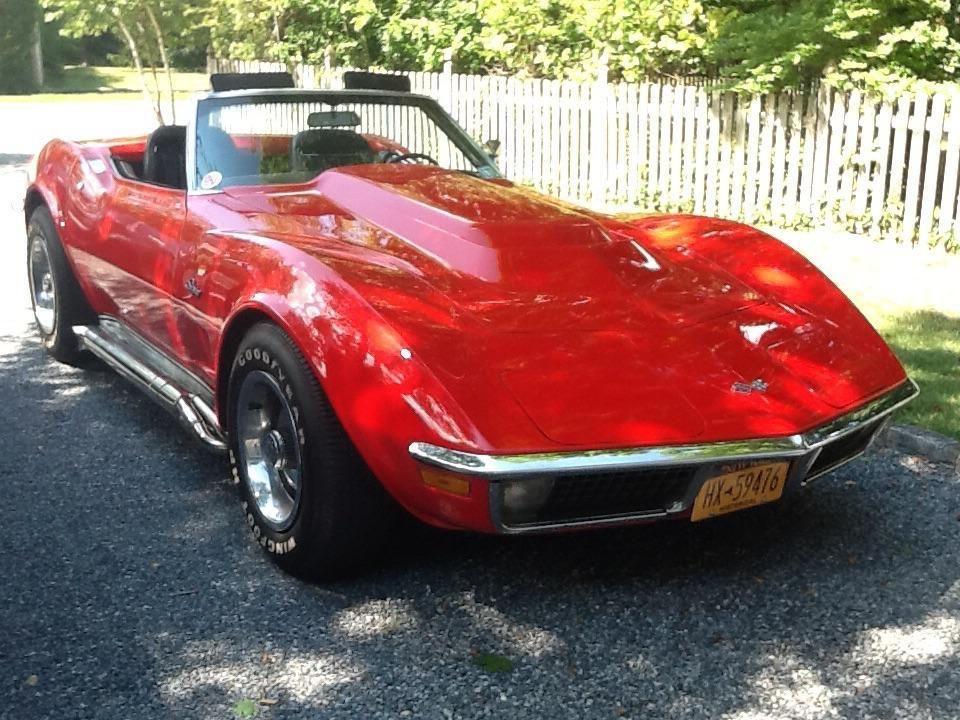

i believe the Eckler long L-88 is higher then stock L-88 hood.i am using eldobrock air gap and still all kinds of room.my problem is the car is is way to fast for me at 70yo .i have highly modified 700r-4 with world champ build 409" sbc. i put foot on brake rev. to 2600 and mash down on gas and the giant nitto`s just break loose and few turns.front of car lifts off ground and left front wheel has air under it. i cannot control car in straight line so i do on 3 lane highway. car goes 7 grand and shifts ist to second.what i am doing wrong?.
.photobucket[IMG]http://i140.potobucket.com/albums/r21/BobLico/imagejpg4_zpsf241b404.jp
g[/IMG]

the heat above the SS headers at the AFR cylinder heads heads is 270 degrees so i feel fresh air from the cowl is almost essential. i installed parogon kit with duel inlet to cowl.all sealed and glassed in with radius corners on intake edge at cowl end of hood.

Not seeing big nitto's in picture,old picture?

i should update photo,all four tires were changed to nitto drag radials in rear and 235/70/15 nitto brand performance in front which fill the stock fender wells perfectly.i had drop air cleaner with open air filter runs better with cowl induction L-88 set up but like i said the cut out in rear of hood are perfect and blend into the two under-hood ducts.been 50 years since i have been to track and have no idea how they 0 to 60 mph drive a auto vehicle like this. the wheel only break loose enough for a chirp with 20 pounds of air in rear tires. i have billstein shocks all new poly (upper,lower, ball joints,A-frame,hein joints ,all new Moog universals.everything light up front (w/p,fans,manifold,heads,all a/c removed.) street car use sometimes for drag race or high speed run on the highway also car shows every week.very hard to hold car at line when exceeding 2400 rpm, convertor is 2600 rpm.fabulous brakes will not hold that power back.
