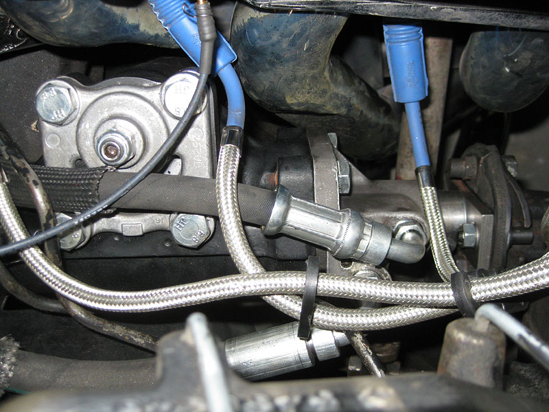

right, had to dimple 2 pipes of the Hooker Sidepipe headers at a BB C3:

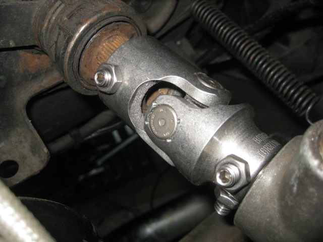

Do it, you will be satisfied.
And use this joint, not the rubber-coupler that comes with the set.
My coupler started to breake after only 2 years!
My coupler started to break after only 2 years!
What part number is that u-joint?
Old Feb 23, 2014 | 07:29 PM
zuendler's Avatar
zuendler
Joined: May 2011
Posts: 722
Likes: 58
From: Karlsruhe (Germany)
http://www.summitracing.com/parts/BRG-114350
