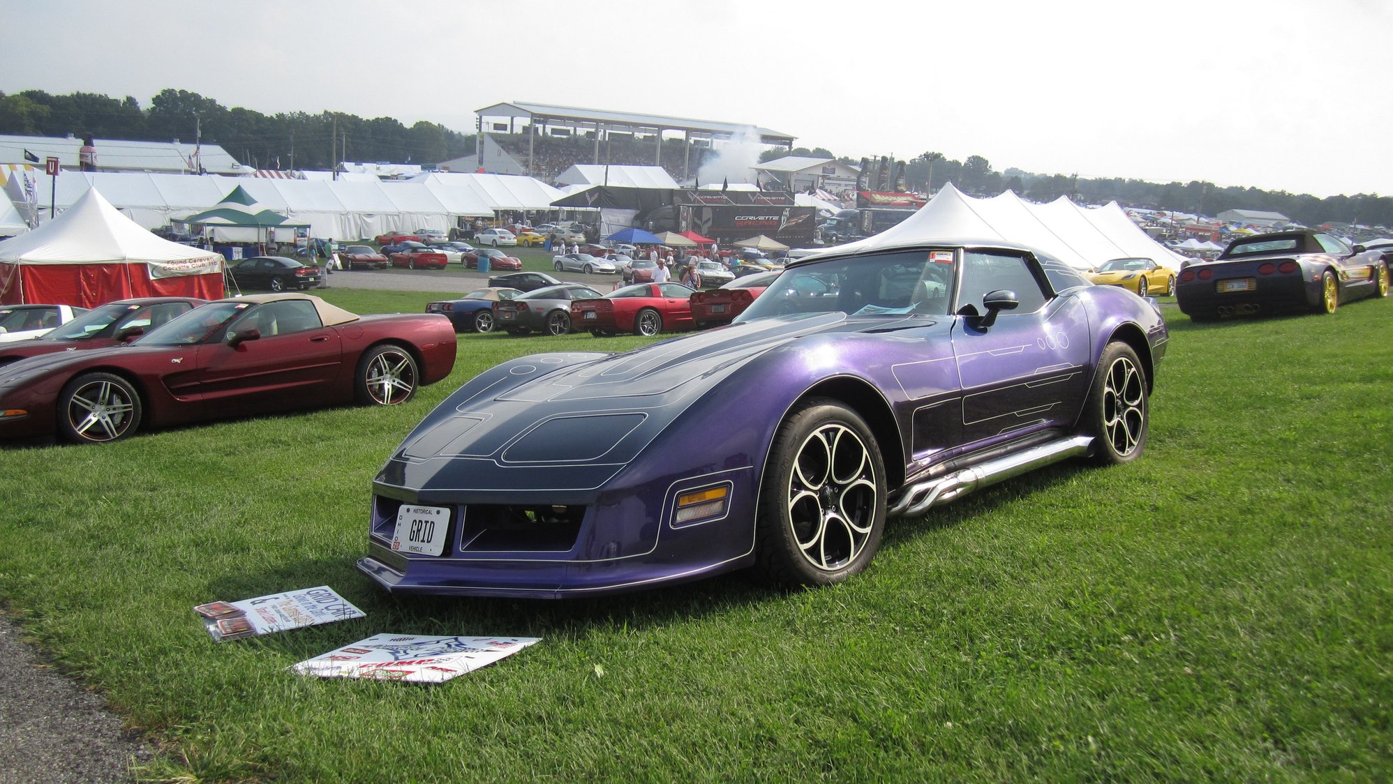

Ok, it didn't take long at all to find the GRID Corvette. I think I had been parked for all of ten minutes and started walking toward the grandstands when I saw the GRID car roll in! Cannot miss it and you should not miss it. Great looking Vette with some great personal touches to it.
Great to meet you guys too! Hope you made it home safely and without any incidents.
The smoke in the background is just the burnout contest, no Corvettes were on fire or harmed during the taking of this picture.
