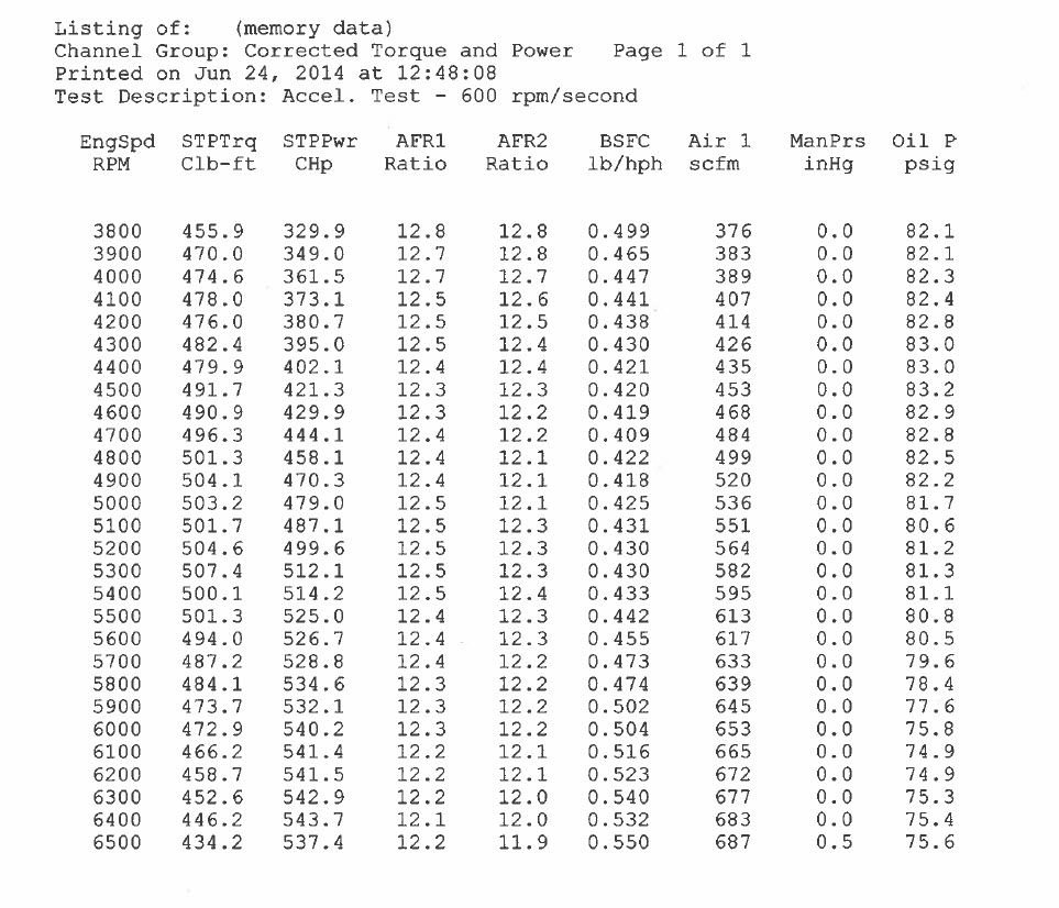

383, pump gas 10 to 1, 750QFX carb, 210 AFR, Camshaft 237/241 .050" on a 108

Thanks Chris! How does that 108 in a 383 idle? Sound clip anyone?

Ok. I like that. Not too rough....dont want the Wifes teeth to chatter.
My calculator shows DCR at 8.44 with that cam. Should work great.

http://s160.photobucket.com/user/2he...48859.mp4.html
Video of this engine on the dyno.

Uhhh, that youtube video is of a 383 AFR headed 195 on an engine run it stand. Not a dyno. An engine stand is for test firing an engine and verifying oil pressure, any leaks, or any visual issues before the engine goes in the car.
This post was to answer the idle question post about the camshaft.
The post 2 down is the engine that made the dyno sheet I posted. This engine belongs to one of the engineers at Federal Mogul.
