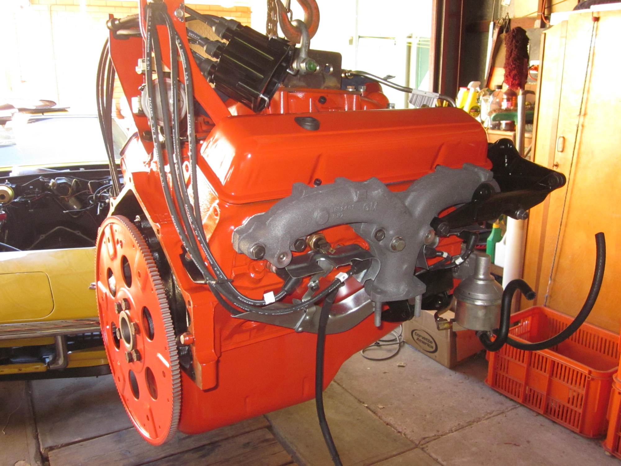

ground wire is shown hanging down under the number 6 plug, there is a tapped hole on the side along the top edge of the block
wire is about 12" long and the other end bolts to the side of the frame by the engine mount
from my 72 rebuild
