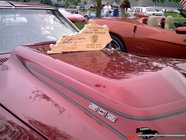

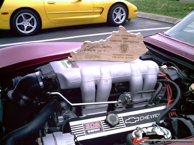

Your going to need a taller hood for this one!!

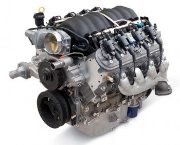

LS3 525hp GMPP crate motor
