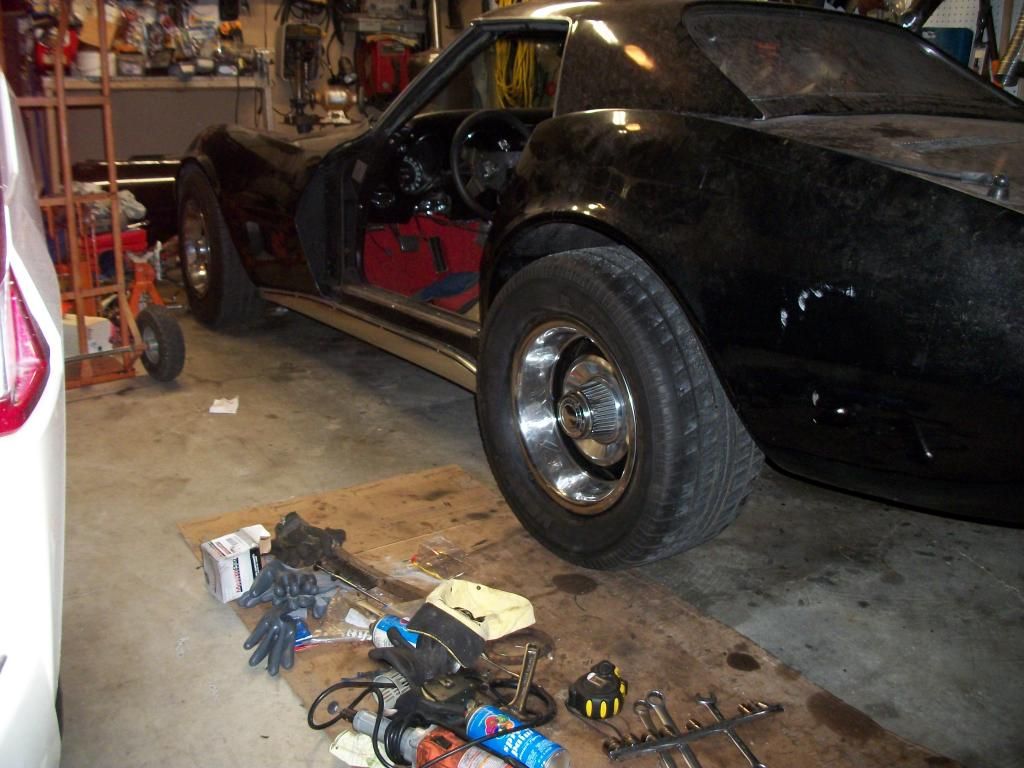

Some do what you mentioned in your thread. in my case I cut my front springs and I will use 8" bolts to lower the rear slightly. I wish to keep a slight rake with the staggered wheel/tire combo. As you can see I do not have 15" wheels.

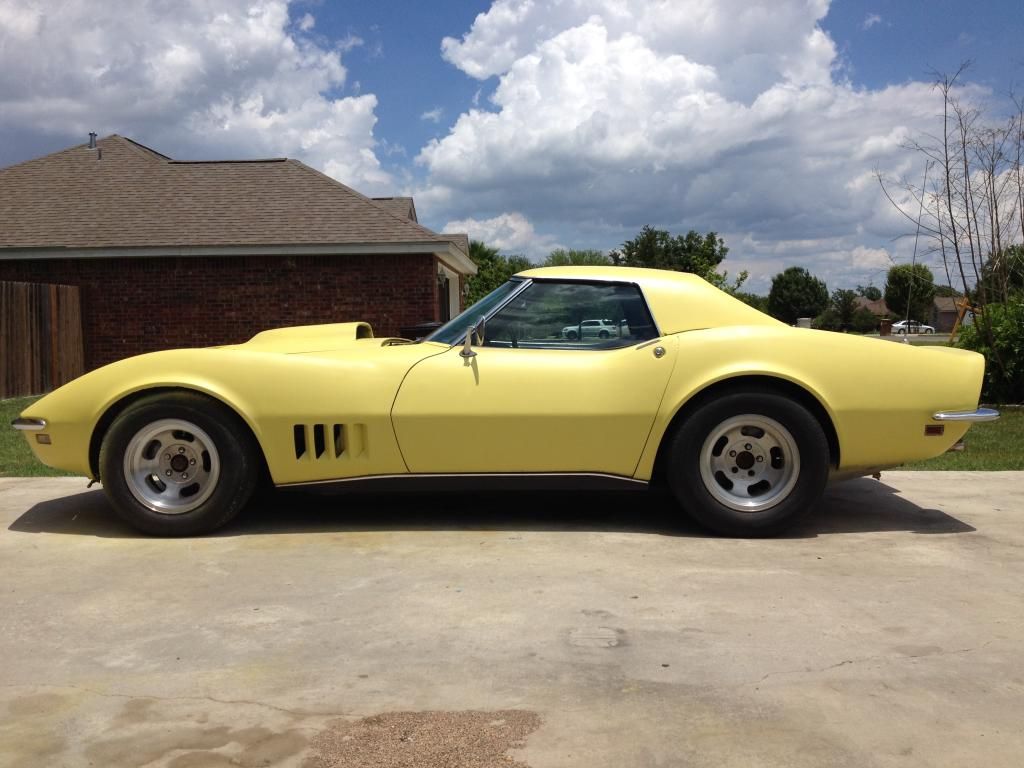

This is an original 69 427 and it is 27.25 inches front and rear from the ground to the fender at center. Probably sagged a bit since factory....

Original 68 BB F41 suspension measures 26.5 front 27.5 rear and running 255 60 r15 rear 215 70r15 front.

Wow... Some good looking cars. I'm pretty surprised tho at the discrepancy between ride heights with different "stock" setups. Mine looks a lot like Doorgunner's right now although I'm looking to get more of a CanadaGrant look. CG, your springs must be good and broken in to get such a nice ride height out of a stock setup.
This is about as perfect stance as you can get. Tires fill the fenders nicely.

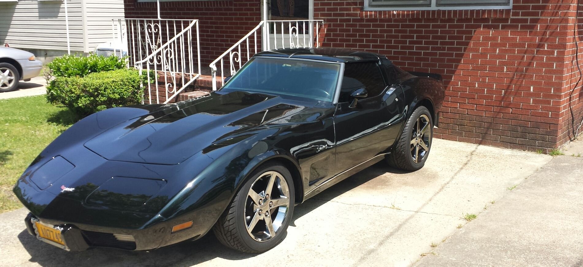

Cut one coil from the front spring's. Installed C-4 rear spring bolt's. 225-70's.
