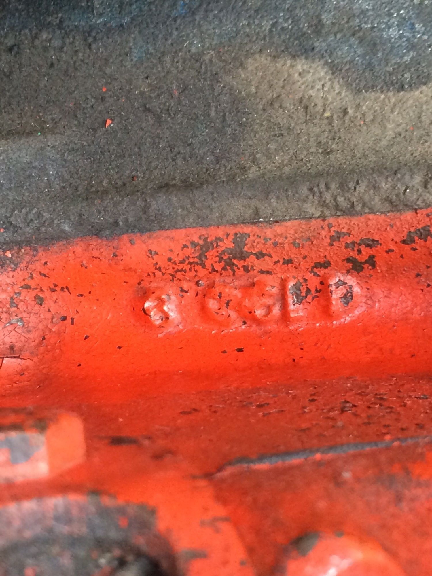

Hi I'm looking at purchase of 73 C3. Total corvette rookie. Learning from is forum, here is what I have figured out.
Not numbers matching, no VIN ID on block.
Casting on block is 3963512 T so might match 454 badging in hood at least, but....
I believe it's a warranty replacement or crate.

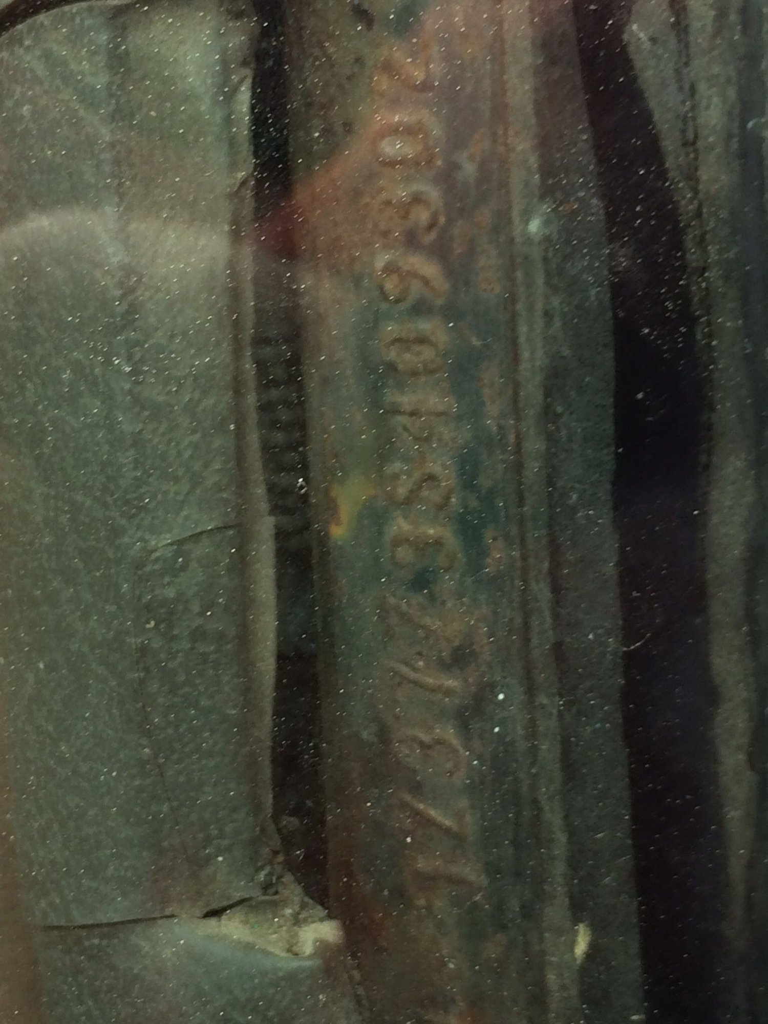

The VIN stamp location in front of valve cover has CExZZxx O
The date stamp, I'm taking a flier that it says 1 19x 8
Only other stamp other than firing order is CONV 1 GM5
Can someone shed some light on what I might be looking at?
Thank you fellow gear heads!

The 3963512 block was not used in Corvettes after 1971, so that's an additional clue that this is not the original engine for this car. The CE stamp could be either for a crate or warranty engine, but obviously not warranty for this car. There's no way of knowing what's inside without disassembly.

Thank you all. I guess more specifically, my question is, is there any possibility that the engine I refer to is a 427 crate? As well, I wanted to eliminate the possibility that this could have been a truck engine. Initially I was mislead by the 'T' that follows the 512 code. Understand now that refers to a manufacturing facility. As I understand it, if the CE is a crate engine (is that conclusive?), there is no way to verify if this a 'corvette' engine. But does the 454 crate still have marketability?

512 blocks used for 427 and 454 engines with both 2 and 4 bolt mains between 1969 and 1971 and installed in cars and light trucks of all types. CE engines were also supplied for all truck and cars models.

One more question. I've learned that the CE 512 engine was made in 1970, so to end up in a 73 vette, must have been a shade tree install from one wrecker into another. HP ratings on the 1970 454 4 bolts run from 360-450 hp. Possibly the one I see is of the 360hp variety? No aluminum heads or anything, any other possible clues to look for to narrow it down? Can one assume that any 454 made in 1970 at the Towanada plant that's a 4 bolt would be a minimum 390 HP??? Fingers crossed..... Tell me something good, lie if you have to!
In late 69 and 70 the same block 3968512 was used in both 427 and then 454's. The diff was that 427's were internally balanced and not 454's but same block. Check behind the front balancer. If it has a counter weight inside, it's a 454.

Since this doesn't appear to be a dealer installed warranty replacement I don't think you can make any valid assumptions on what's inside that block. Even if it were numbers matching there's no way of know what's in there once the engine has been worked on.
You could check the casting numbers on the heads and intake to get an idea whether they were ever used on a Corvette application. No easy way of knowing what it has for a cam, crank, or pistons without tearing it down.

How did you determine that? Big block engines were installed in all sorts of cars and and trucks, how do you know that this engine was built specifically for any Corvette?

The stamp in front of the valve cover upon closer inspection reads CE07785 0. So, one resource I found said this would be interpreted as a warranty replacement post 1969, with the 0 designating meaning made in 1970, the first 7 indicating it was made at Towanada plant, and the next four digits being a sequential production number 7850 of 7999. Is that possible? The bottom half of all the digits on the stamp are illegible, I'm pretty confident in the CE07785. 0, but it could also say 'Made in China' for all I know.....
Old Jun 30, 2014 | 11:44 AM
Mike Ward's Avatar
Mike Ward
Joined: Jul 2001
Posts: 15,892
Likes: 42
The 0 after CE typically means that it was assembled in 1970. All GM big block engines of the era were built at the Tonawanda plant.

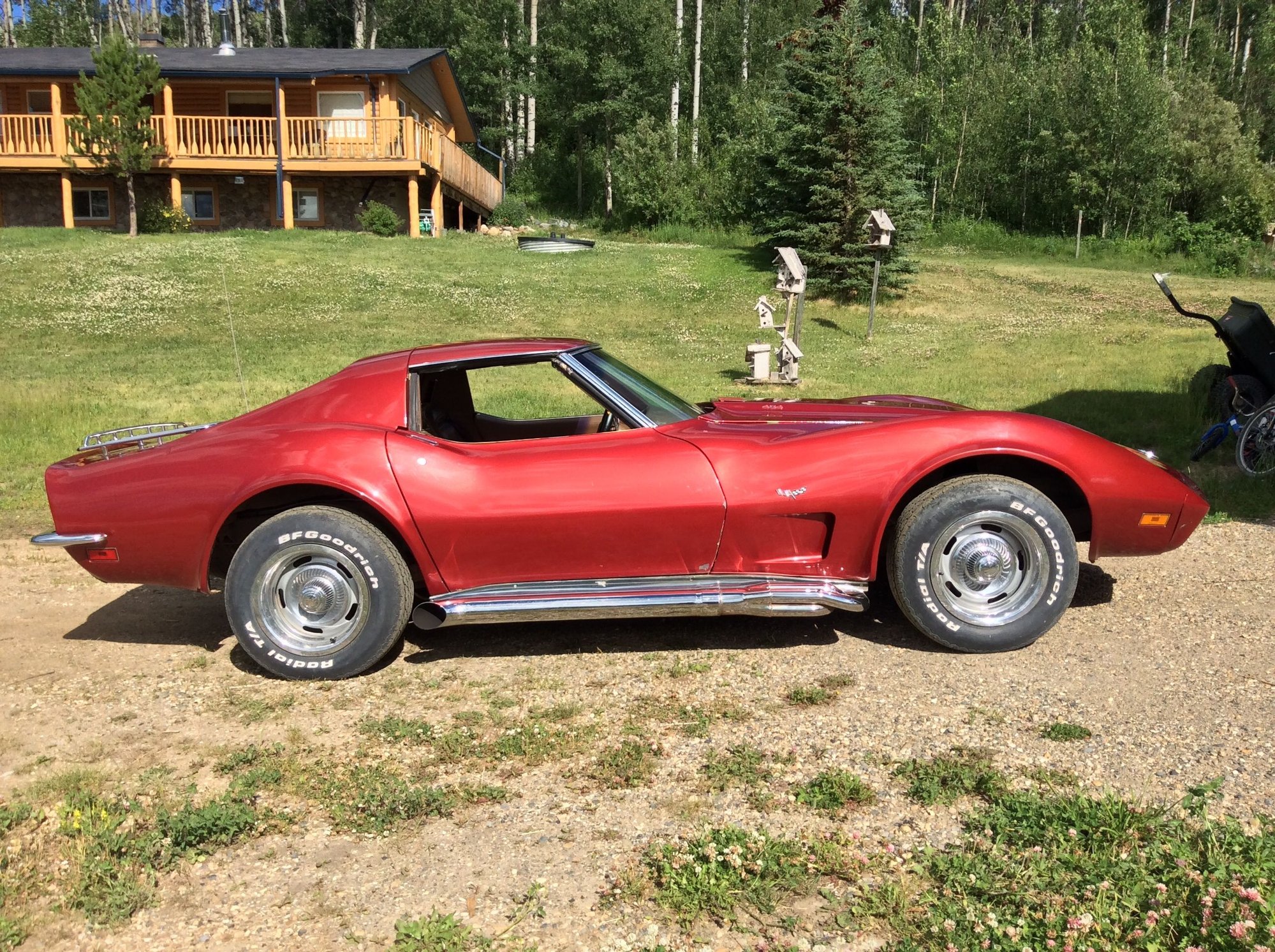

So despite your good advice, I bought this car anyways. Luckily for me, closer inspection in my garage, it's not nearly as bad as I thought. E windshield frame up by the T-bar roof will need to be replaced, but other than that, everything is solid enough to drive today and restore tomorrow. The issue in front of the rear wheels is limited to drivers side, no rust through frame, a few flakes on the outer rail. It's a big block car, designated by Z in ViN. The block is a 3963512, Serial number not matching car, it is warranty replacement CE077850. Discussing with previous owner, the block came from a 1972 Vette - not original to that car which was news to him - and it has the steel high performance crank.
The intake is correct to the 73 Vette year according to cast number 353015. I won't be pulling the engine apart for a while, need to save funds for complete resto in a couple,years. Will change the valve cover head gaskets this winter and get the rest of the info then.
The PO put in a new rad with supplemental electric fan, changed the alternator, and put on hooker headers and sidewinder pipes. The PO painted the car about 10 years ago, prior to that looks like it spent some time in British Racing Green and a darker yellow since it's original light yellow factory colour. The last paint job suffers from multiple cracks, flakes and bubbles, about 20, but it's fine for now. Rear chrome bumper is flawless, front flex bumper is solid but suffers from worst painting. It has factory air conditioning, but the pump and pulley was removed, but came with car, looks like it's seized. Power windows, power steering, power brakes. 3 speed auto trans.

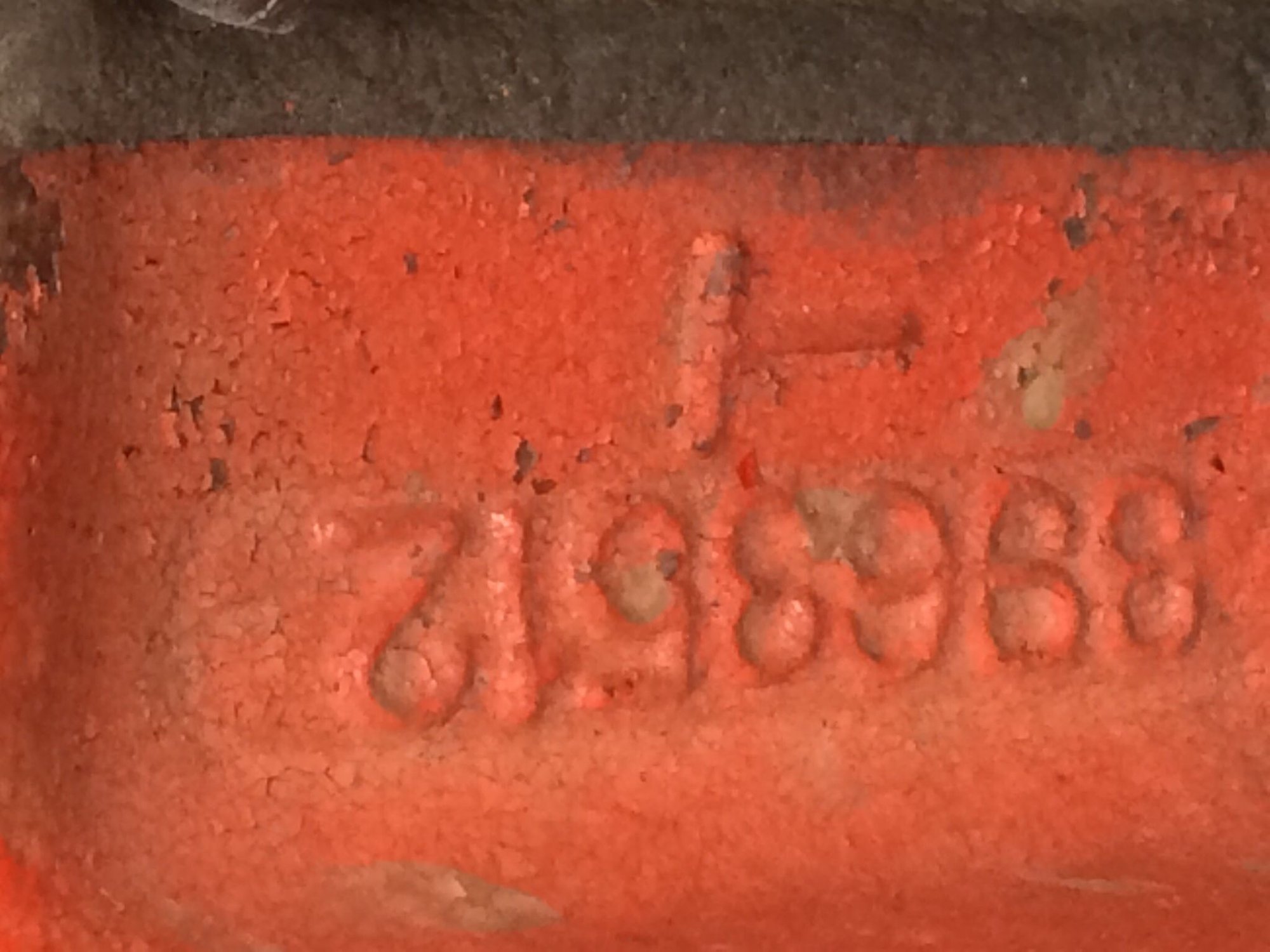

Third - and better guesses on that date code picture? Since the CE number puts it at 1970, I can see I 19 0, but not even sure if I'm looking at it right side up (I think it's upside down in photo).
This engine was not a warranty engine for the 1972 Corvette either. It wouldn't have sat arounf over two years waiting.........
Being that the engine was assembled in 1970, it was built most probably as a short block for a '68 or '69 who knows what kind of truck or car that was still under warranty, or a crate assembly again for unknown purpose.
Speculating what sort of power the engine makes is futile. Have you figured out whether it's a 427 or a 454?

Good point. So it had been previously installed elsewhere, as in, this is at a minimum the third vehicle it has been installed in! To determine if it's a 454, one would find a small weight on the inside of the crank pulley, correct? Did that date code picture reveal anything to you?
