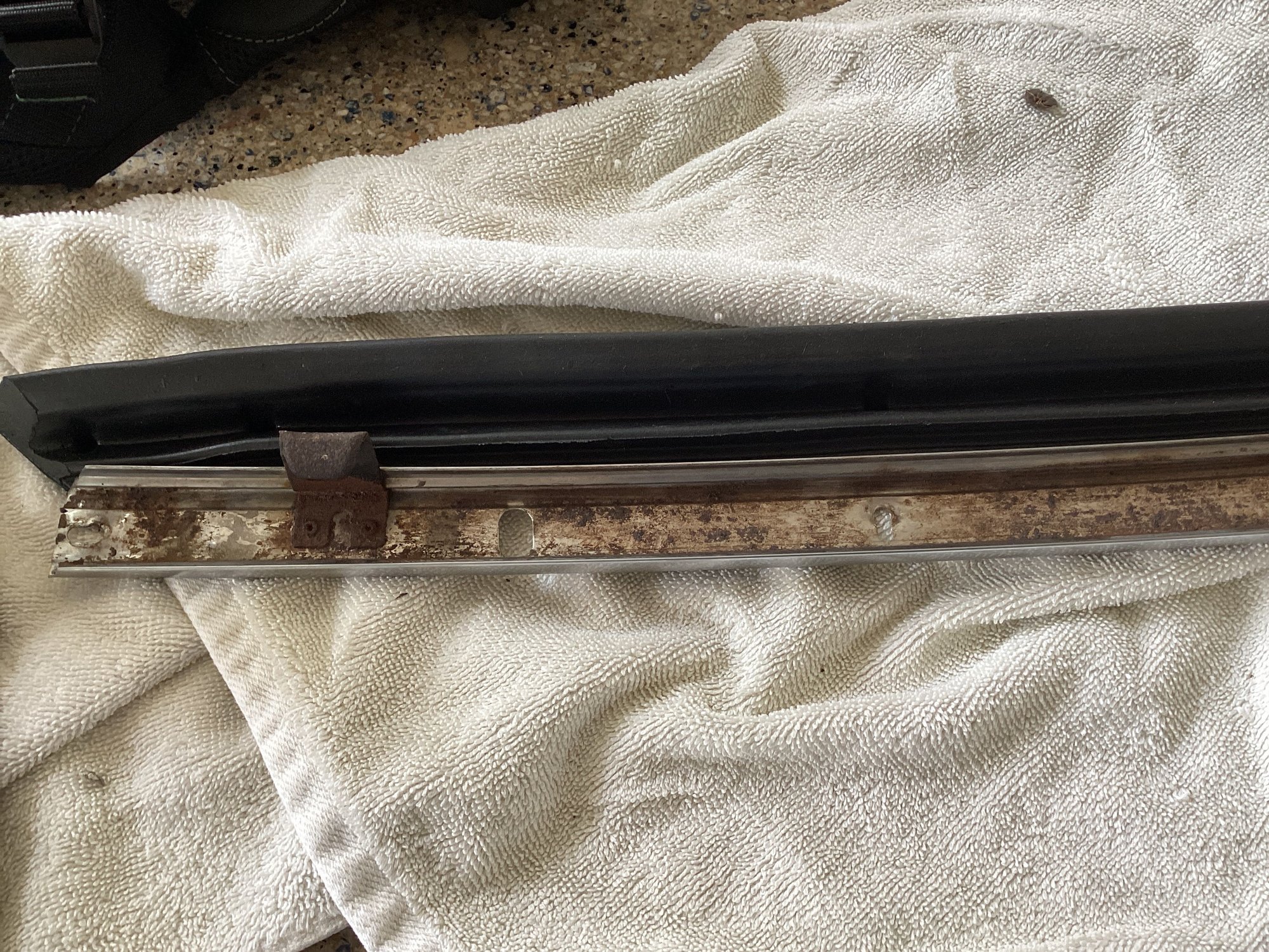

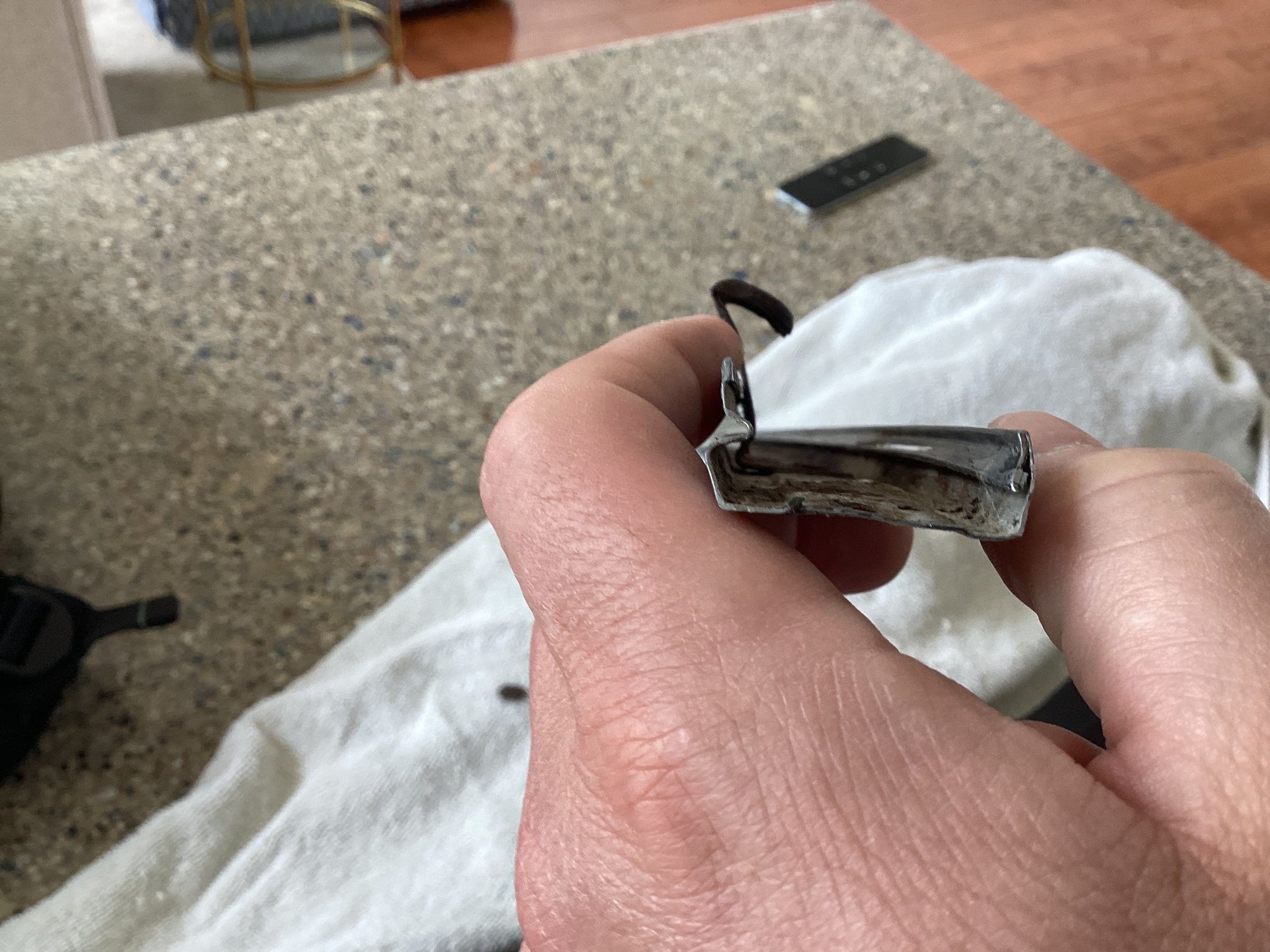

I know this is a very old thread but thought I would ask here instead of starting a brand new one.
What is the trick to get the weather stripping into the retainer? I can see where it looks like it should go, but the retainer/metal is crimped, I would assume to hold in the original weather stripping.
What’s the best way to ‘open’ back up the retainer so that I can get the weather strip in there the right way? Or is it best just to buy new retainers?

After cleaning up that channel, try heating up the weatherstrip. Boiling water works. Then get the rubber as hot as you can handle it and dry it off before inserting. This should help get it into the lightly glued channel.
