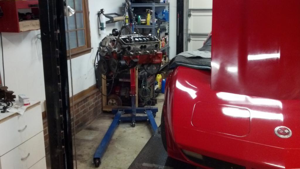

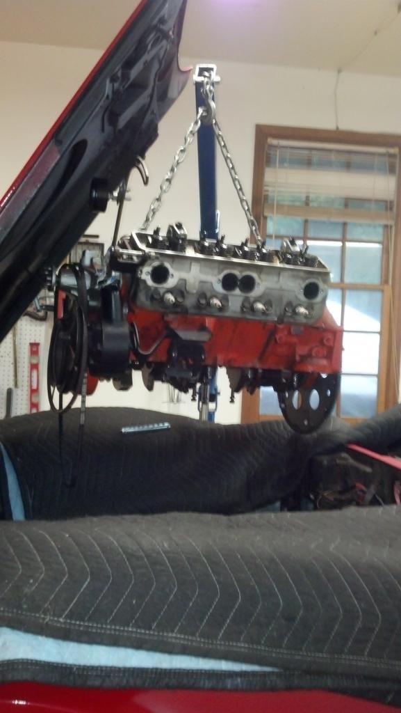

Yanked it with the hood and wheel on - was really close on space.

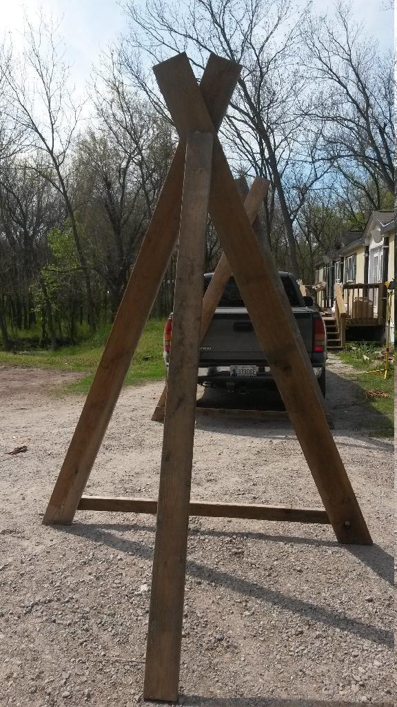

My two ton simply wouldn't work. Not long enough. Side wasn't an option either, as I',m working in gravel. After pulling the radiator and the radiator support, the entire motor and trans came out with a home built A Frame.
Some 2x8's and a few long bolts

wow you got some Nuts! ...I would not have lifted them together for that pull /weight,
on that frame setup. But hey it worked for you. is that red spot on the ground your blood,
or tranny fluid ! Necessity is the mother of invention !
Awesome! Very creative.
I thought of spanning my lift with a piece of lumber to function as a winch.
