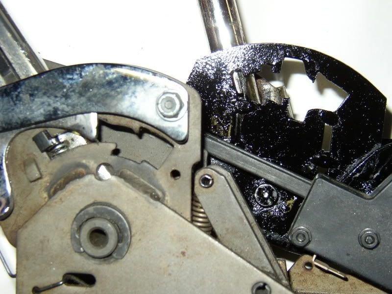

This Hurst shifter took a lot of work to install "properly". I opened the gate up, modified the reverse lockout lever, deformed the floor pan, added 1 inch square tube channels under shifter to establish correct height. I was a royal pain....but worth it to me. Good luck! Jim
