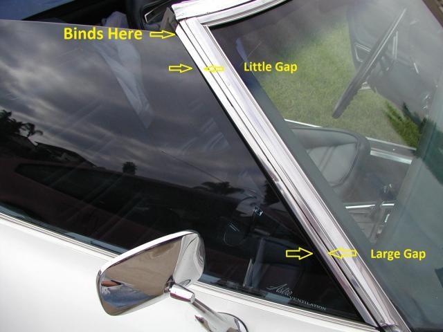

Good Morning.
Here's my problem.
It's so bad the electric window motor won't drive it all the way up with the door closed. New weather strip installed.
Studied the diagram I had and was unable to decipher which bolts adjusted the fore/aft tilt of the window top.
Can someone please enlighten me?
Thanks so much.
Steve

I just looked at your picture. The adjustment for the chrome strip in your picture is actually done by two bolts under the weatherstrip (which also adjusts the weatherstrip). Loosen the bolts and adjust your gaps.

This all started with the notion of replacing the weatherstrip. It is the 1973 original w/s, and a previous owner "repaired" it with a sloppy application of yellow/brown contact cement. After I pulled off the old stripping, I'm left with this trail of old cement to remove (you can see it in the door picture). I tried acetone, and it works, but very slowly. I tried a product called Goof Off: a total waste of money for this application. MEK came to mind, but I had none on hand. I know I'm going to paint before the new w/s goes on, so I'm not too concerned with harshness of the glue remover. I'm using a paint stripper applied just on the dried glue with an acid brush, and it's working, but it also removes any nearby paint right down to the gray fiberglass. Ouch!

I used the method described by a couple of you guys, loosening everything and positioning the glass by hand.
It's a wee bit tight, but the only other way to further the glass's aft position is to reposition the door, as the window regulator's position is maxed out.
I believe this will be alright, for with time the weatherstrip will conform a bit, and I'll always have a tight seal. Which is what weatherstrip is all about.
